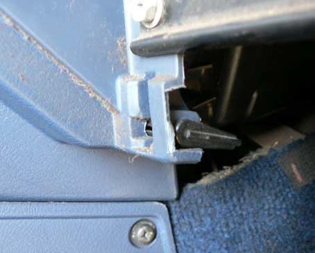

1) the plastic hinges holding the lower part of the glove box

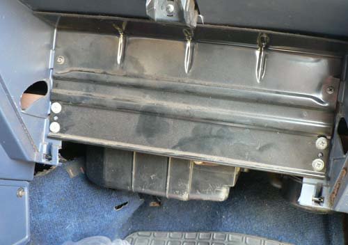

2) the metal piece, 4 10mm bolts and 2 screws to remove

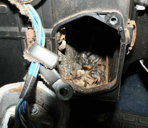

3) suck out the debris
