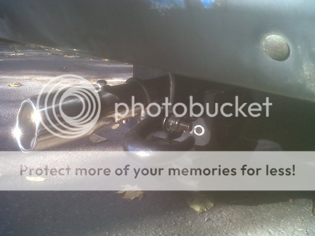

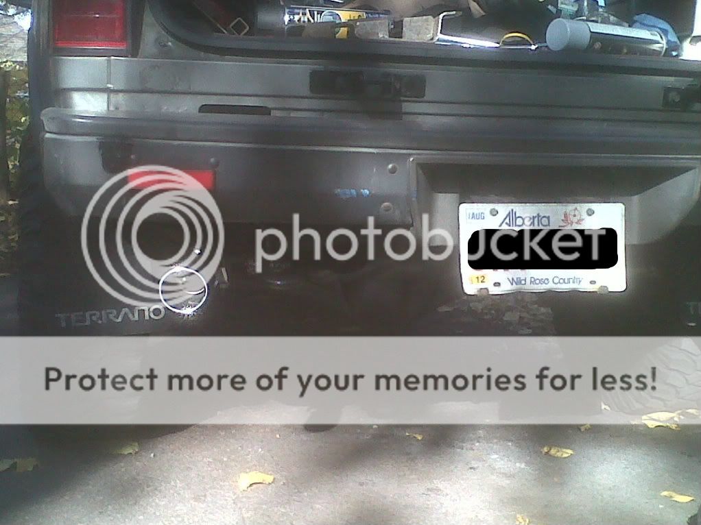

yesterday i mounted my new stainless steel tail pipe. just a little thing, but i thought it really makes the truck look good:
this is what was on there before:

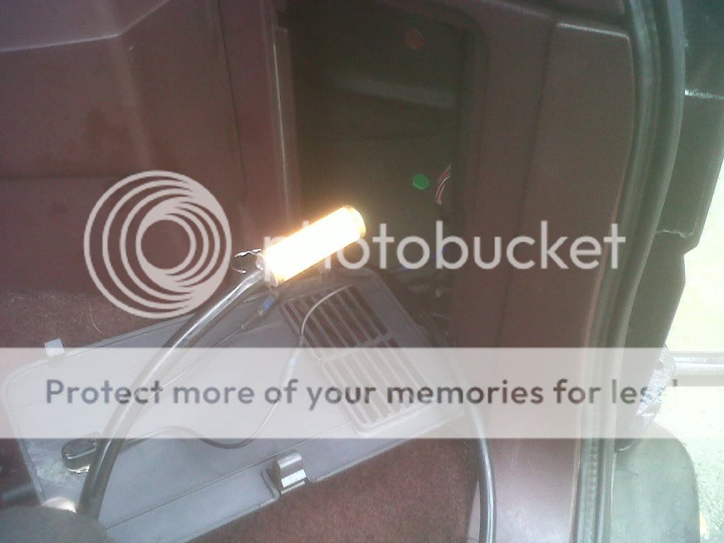

i also routed my rear diff breather up into the cab (between the body panels), and i put a fuel filter on the end of it to keep out dust and debri. as it was, the breather was just stuffed inside a pipe at about the same level as the bottom of the fuel tank. i thought it would be really easy to get water inside in its stock location:

i think technically you have your exhaust tip on upside down, the little drain hole is 'supposed' to be at the bottom :lol: all about personal preference though. Don't forget to extend the breathers on everything else too!
thats funny, i was wondering the same thing. didnt know what that little hole was for...
it will get flipped...
