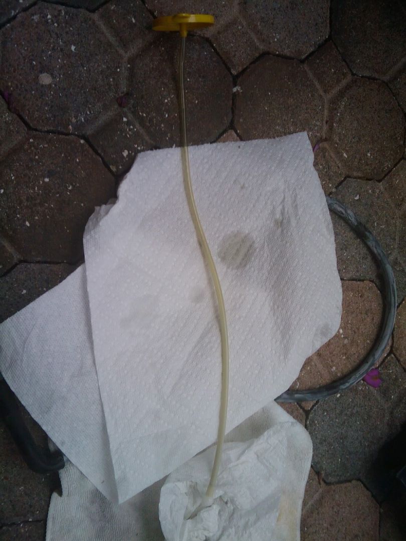

What is the point of this thing under my washer fluid filler cap? It's all clogged up with sediment.
