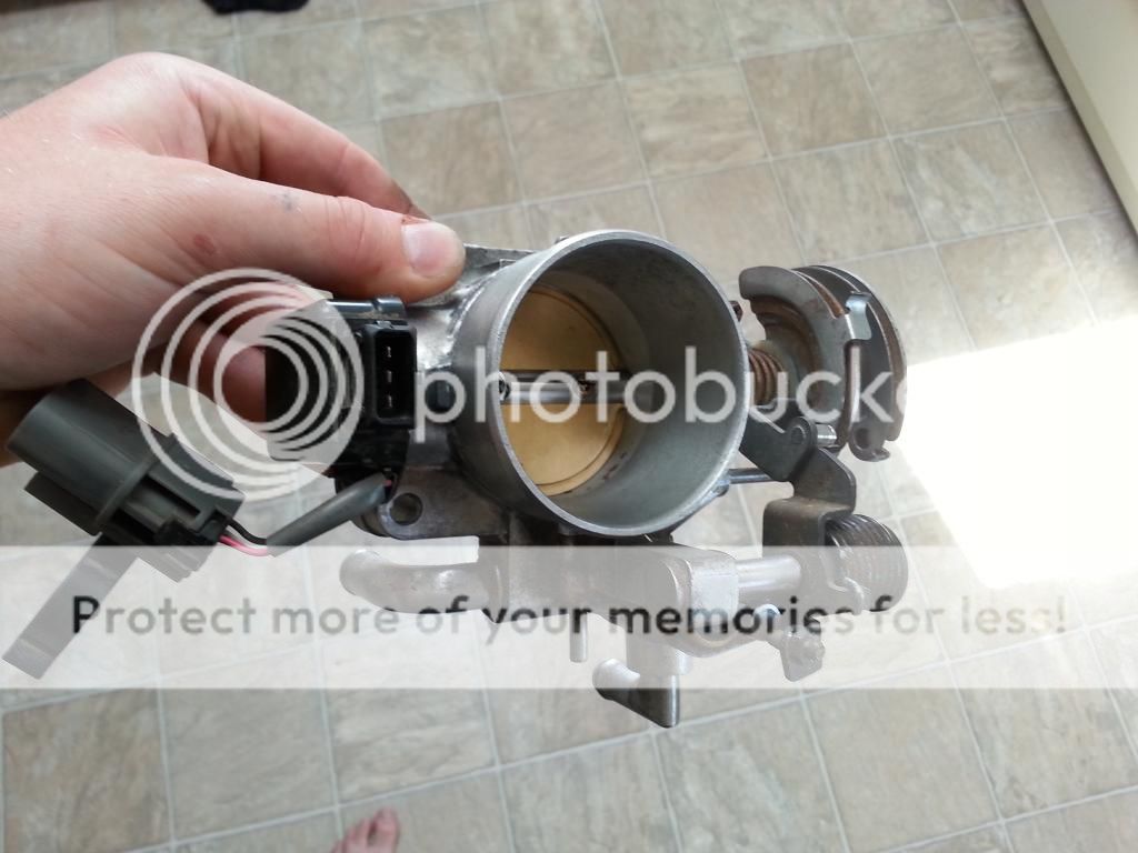

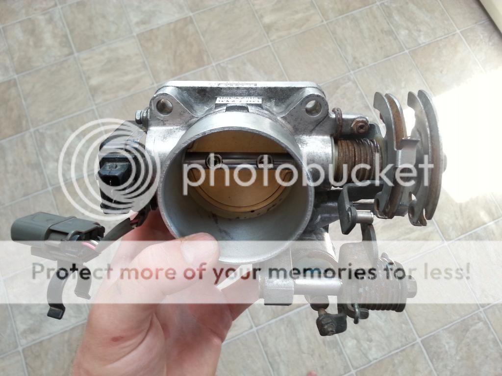

Pulled apart my vg30 throttle body and gutted it for parts. Machined down the vg33 throttle body to accept the vg30 tps sensor. Mounted the vg30 tps backwards to match the throw of the vg30 throttle actuation. Machined the slot of the vg30 throttle shaft slot wider to fit the vg33 throttle plate. I now have a functioning vg33 throttle body with vg30 peripherals. Now just need to figure out the under plenum lines to make this tb work.... almost there! The vg33 throttle plate is so much bigger than the vg30 one, but the inlet outer diameter is the same so the accordion pipe will slip right on. Just a few more things to figure out and I will be running a full vg33 engine including throttle body and intake manifold in my 93!
