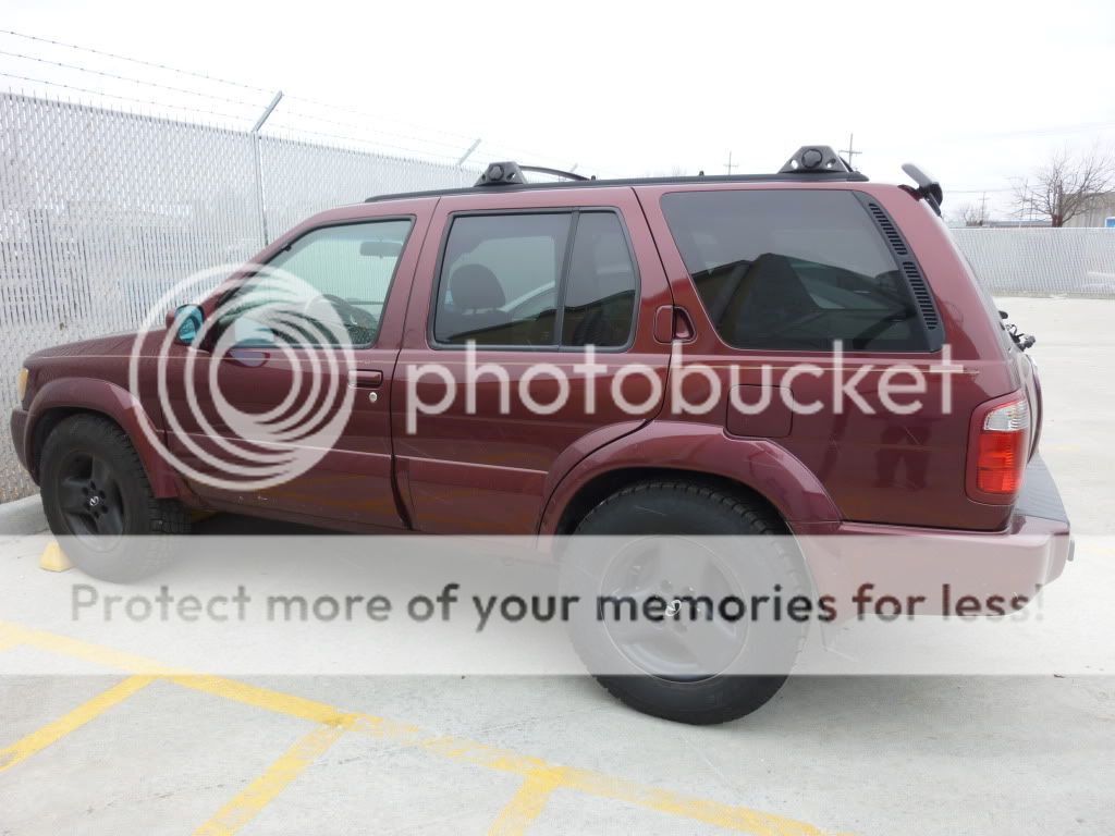

Year: 2001 QX4
Lift: Stock suspension
Wheels: Stock 17" Wheels
Tires: 265-70-17 Nitto Terra Grapplers
Notes: Had to heat up the front fender liners and re-form the plastic several times. Added new bolts and fender washers between the bumper cover and the bottom of the steel bumper backup to lift the bumper cover and gain front fender clearance. I took out the turn signals/fog lights to heat one side of the fender liners while pushing out on the fender liners with my hand between the tire and the liner. I used leather work gloves and the heat from the heat gun is practically unnoticeable. I think I notice a little rubbing in reverse at times, it's really minor. No problems with the strut, but it is really close. On some severe dips it will bottom out and rub on the front fender flair connections at the top. I think the stock springs are sagging some, and I could add strut spacers and probably fix the bottom out issue, but I think I will raise it 2". I have removed my running boards, the steel frames were pretty rusty.

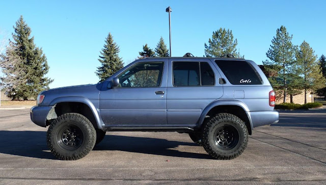

Year: 1999 Chilkoot
Lift:OME 0.5" springs and OME shocks and struts
Wheels:Black Steelies
Tires:31x10.5x15 Goodyear Wrangler duratrac
Notes:Slight Rubbing in reverse at full lock

and now with the OME suspension and black steel wheels with 31x10.5x15 duratracs
