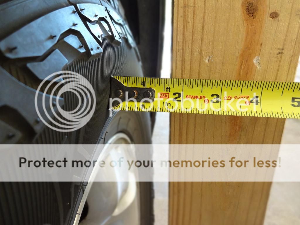

1998 SE 4x4
Wheels: 15 x 7
Tires: Hankook Dynapro AT 31x10.5x15 LT
Lift: Nope
I put a 2x4 flush with the fender flare and leveled it so you could get an idea of how far inboard the wheel sits in relation. All of the these measurements were taken out to the board for reference.
10.5 inches?!
I should have used something for reference, but it's about a 1/4" gap between the tire and strut.
My measurement for backspacing was nearly 5.75". I had to add a 1/4" for the outer lip. Would a 2" spacer push the tires beyond the fendert? Precise1, you say that your tread is actually 10.5? With my 8" tread I guess I would need a 2" spacer to get my tires flush.
The clearance between the strut and the tire looks really close for comfort. Wouldn't that lead to issues?
Looks really good though. Makes me want to get 31" tires for my path, too bad I'm not comfortable mounting it on my 6.5" stock rims
