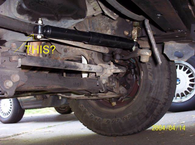

jdub Posted August 5, 2004 Share Posted August 5, 2004 Anyone have a pic of the piece of the centerlink that needs to be ground down? My shi...stuff is supposed to be delivered today. Thanks. Link to comment Share on other sites More sharing options...
statikuz Posted August 5, 2004 Share Posted August 5, 2004 Check out the very first picture that 88 posted showing installation of a stock stabilizer. See the tabs on the centerlink where the stabilizer is attached? That's what needs to go. Link to comment Share on other sites More sharing options...
jdub Posted August 5, 2004 Share Posted August 5, 2004 This? Link to comment Share on other sites More sharing options...
88pathoffroad Posted August 5, 2004 Author Share Posted August 5, 2004 Yes. Link to comment Share on other sites More sharing options...
