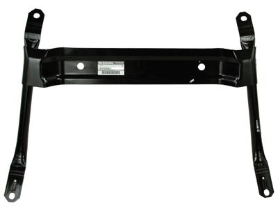

Smallpathy Posted October 17, 2018 Share Posted October 17, 2018 Did you remove the x brace?Sent from my Pixel using Tapatalk Link to comment Share on other sites More sharing options...
hawairish Posted October 17, 2018 Share Posted October 17, 2018 46 minutes ago, Smallpathy said: Did you remove the x brace? This thing? I'm not sure it came on 01+ trucks, though I'm certain it fits. Nissan calls it an Engine Cradle Stay (54465-0W000, $15). When I got my truck, it only had fleurys' front and mid skids on it (the original style with the access ports), so it's possible the previous owner removed it if it came with the truck. Though, that brace is thin-walled tube and probably adds very little structurally, but I guess better than not having it. 1 Link to comment Share on other sites More sharing options...
