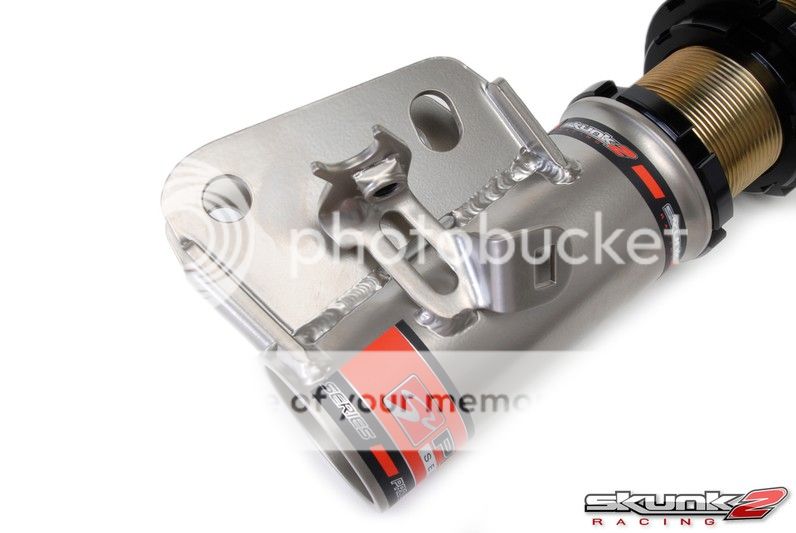

I know your guy is a guru and very experienced BUT all high end, performance, top quality struts have slotted top mounting holes for camber adjustment. So, I,m going to have to beg to differ with your alignment guy.
