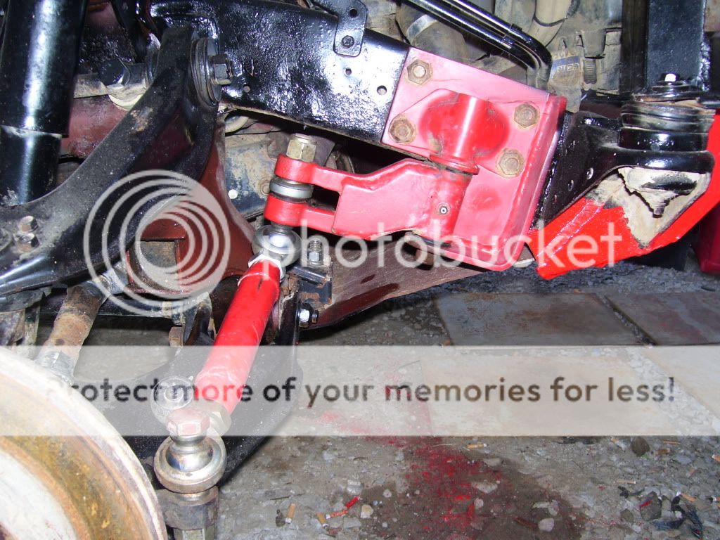

I like the tie rod set up also. Your own design?? How is that working out for you??
B
yes beefy is good but. how are the tire-rods?
I do like that the joints reduce the overall rod angle too. the added stiffness and reduced angle means less slop under travel.
I thought about doing that but, what becomes the next weak link if the tie rods are bullet proof?
I like the Idea of bending or breaking a tierod because it hopefully means someting else didn't
what do you think?
Yes, my own design, The drag link is 5/8 hiem joints and the tierods are 3/4 hiems with 5/8 high misalignment bushings.
The only weak link is my hands,LOL If you stuff a wheel in a rock or ditch it will jerk the wheel out of your hands.
The only draw back is the changed geometry will give about 2" of bumpsteer, but for off road only I dont notice it.
