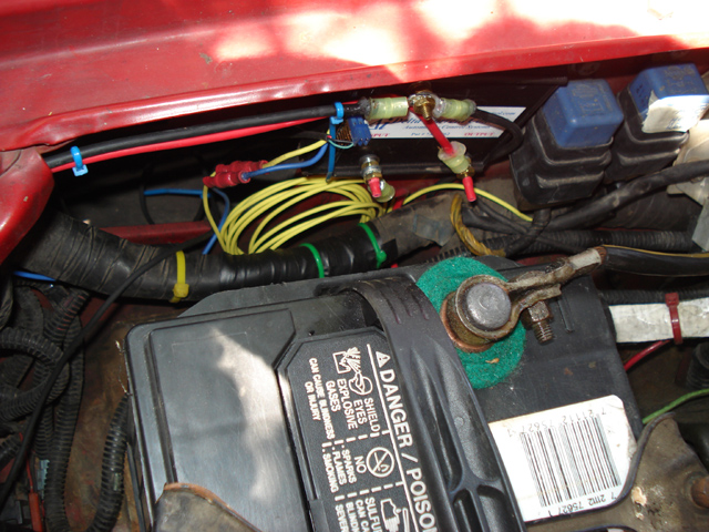

DSC03931s.jpg -
FK-35 mounted on passenger side inner fender. (you supply a 1/8 drill bit, pneumatic drill, optional center punch).
Yellow wire goes to an inline tap (splice/tap purchased separately) to the WB (white w/ Black stripe) wire of the ASCD Hold Relay (second Relay in Pic). It was left coiled because as of yet, I don't know if the wire I tapped at the ASCD Hold Relay (WB wire) is gonna work out.
Red wire goes to battery.
Blue wire goes to an inline tap (splice/tap purchased separately) to the BW wire (careful, there are two BW wires in there) in the harness behind the Pass. side headlamp. This is the A/C wire (it turns on the fan at 50% when the A/C is on). This Blue wire is tapped to the BW A/C wire within the main harness directly behind the pass headlight.
DSC03932s.jpg -
Pic of the Pass. side main harness at the Headlamp. The fresh electrical tape is where I removed the old tape, entered the harness and found (with my multimeter) the A/C wire, tapped the blue wire into it, and re-sealed the harness. I simply ran the blue wire along the harness to this tap termination point.
DSC03934s.jpg -
Pic shows routing of Black (ground) wire. It connects the top left terminal on the controller to the body ground at right center.
Also shows the Red wire routing; along bottom of Batt. tray. It connects to the Pos. Batt. term. through a fusible link.
NOTE: ignore the fresh electrical tape and plastic tie wraps on the main harness below the controller; I tried to find the A/C wire in there, but it was too crowded to locate it.
DSC03935s.jpg -
Pic shows red wire (this is the power input to the controller) routing. The wire disappears as it extends past the batt. tray (I left it too long) and loops back to splice into the brown fusible link (center of pic).

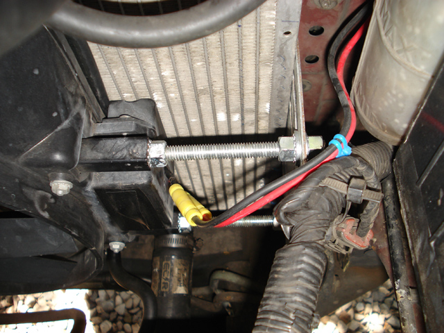

Controller installed - Passenger side
Connections to electric fan- direct to fan (bypassing the Flex-A-Light integrated fan relay)

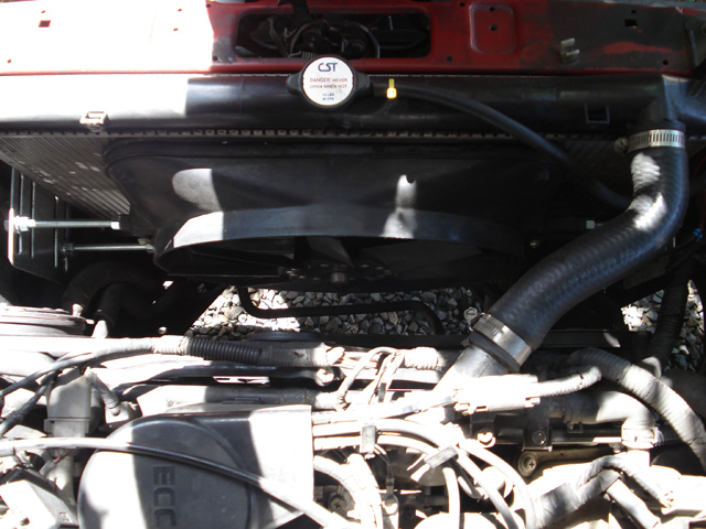

Fan Installed
