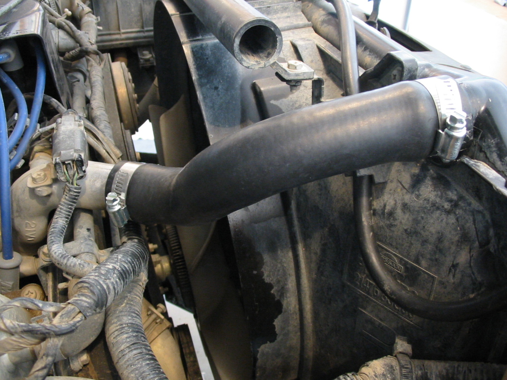

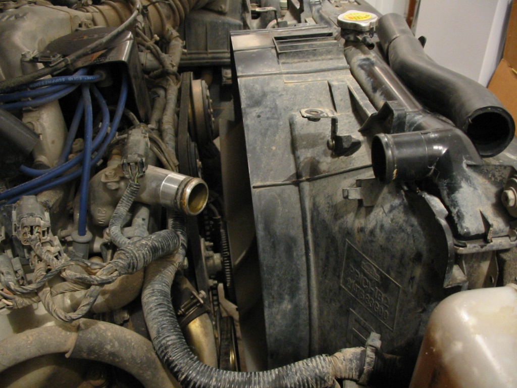

After your body lift, your radiator will effectively be 3" above your engine, putting strain on both the upper and lower radiator hoses, unless of course, you use the radiator drop-down kit. Many people choose not to drop the radiator and have had no cooling problems. If you don't use this kit, you will need to modify the upper and lower hoses in order for them to fit correctly. The upper hose will be too short, and the lower hose will be too long.
Upper Hose: You can't extend the current one, obviously, so you'll need to get a new hose. You could get new flexible hose, with the correct interior diameter, and use that, or you can go to an auto parts store for a new molded hose. I managed to find one that fit pretty much perfectly at my local NAPA, but your mileage may vary.
picture of new upper radiator hose
Lower Hose: Your stock hose will be too long, and there will be a kink in the middle after the body lift. This is easily resolved, some people say they trim both ends of the old hose, but I was able to cut off about 3/8" or so from the radiator end and have it fit on nicely. I cut a little too much off my old hose, so I ended up going to NAPA and getting a stock lower hose to cut correctly.
upper radiator hose removed
While you're out shopping for new radiator hose pieces, it's generally a good idea to get some new hose clamps. You'll need four 1.5" or so hose clamps for the upper and lower radiator hoses.

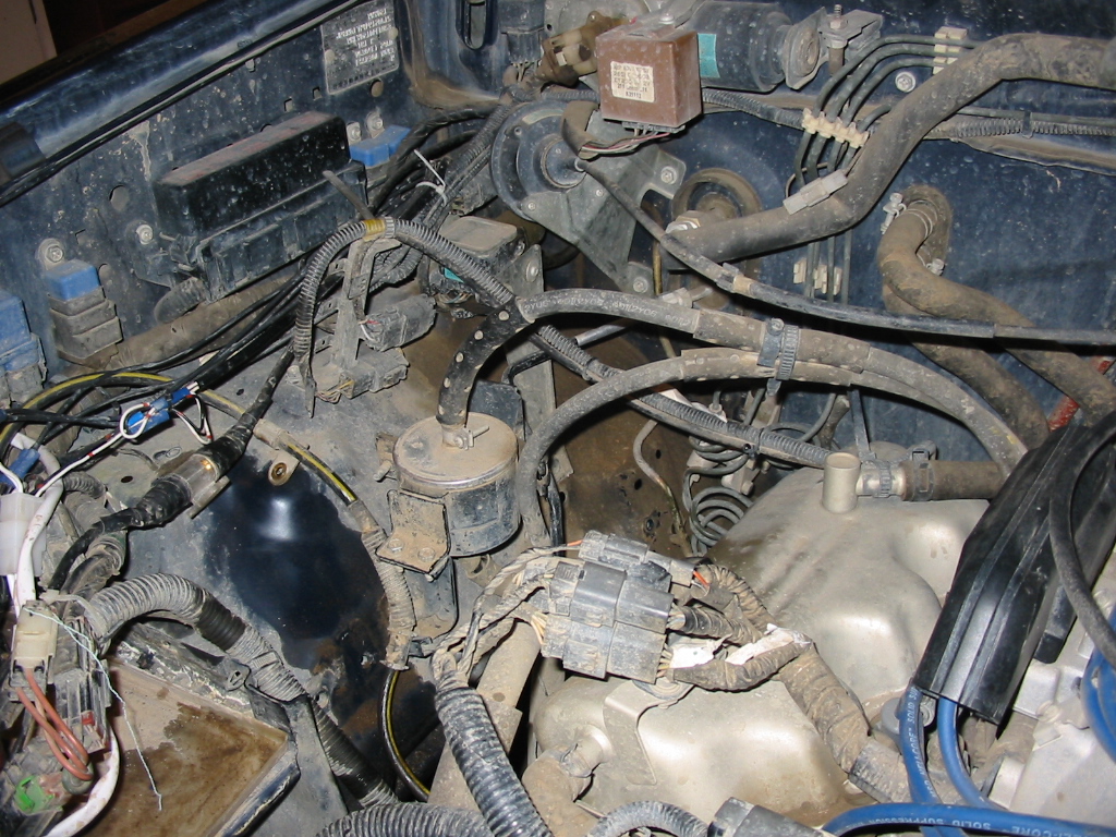

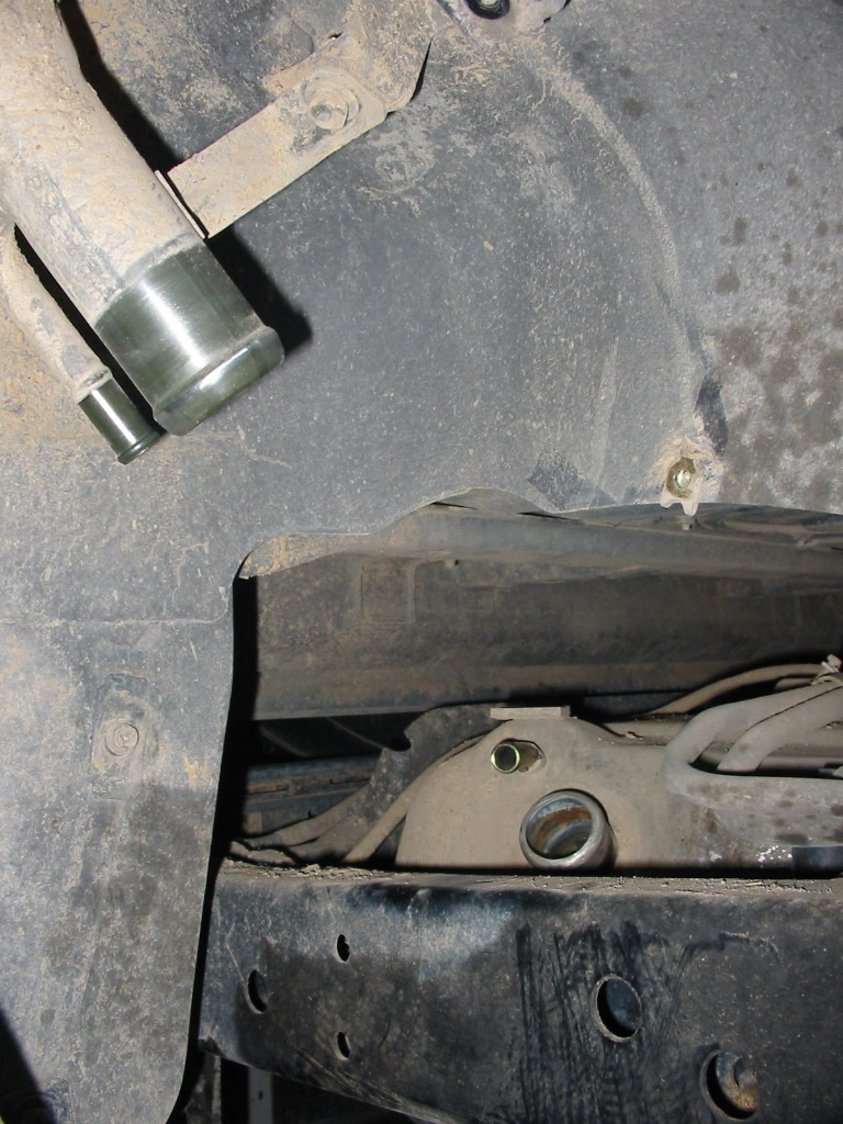

The kit includes a handful of parts to deal with these two lines. First, remove the plastic shield inside the passenger-side rear wheel well, which will reveal the two fuel tank lines. Loosen the four hose clamps, two on the filler line and two on the vent line, and remove both. It's a good idea to stuff a clean rag in the filler neck for the gas tank to avoid getting dust and whatnot in there. I trashed the plastic shield once I was done with this part since it won't really go back on correctly.
Here's a picture of the fuel tank area with all the hoses removed: fuel tank
The kit includes a length of 1/2" black rubber hose for the fuel vent line. For the life of me, I could not get it to fit over either neck, so I went to Checker and purchased 2' of 5/8" rubber heater hose and used that. 2' was a little long, so you'll need to trim it a bit. The kit includes two new hose clamps for this line as well. It's a good idea to install this line before the filler line, so you have a little more room to work.

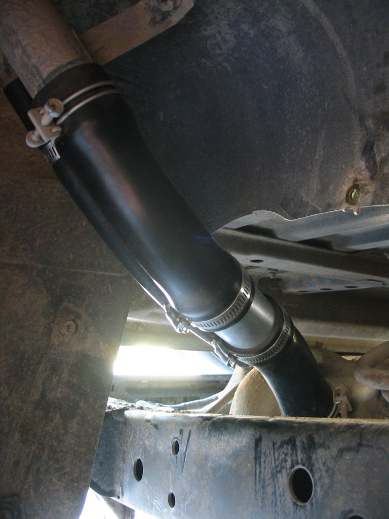

You are provided with a short piece of pipe and two large-diameter hose clamps in order for you to extend your fuel filler line. Cut the filler line somewhere in the middle, then slide the pipe into the newly-cut ends to extend it. It's not necessary, but you can use a dab of Vaseline [or the like] to help the pipe slide into the hose, as I had a little trouble wrenching it in there. Slide on the two hose clamps [included in the kit], and tighten them down.
Here's what it looks like all put together: picture of filler assembly
And installed: filler and vent lines installed

4) I don't believe you can use the stock radiator hoses easily. (correct me...) I used the stock hoses, just twisting the top one and cutting 2" from the block side of the bottom one. Next time I will take 1" from either end.
looks like the stock hoses will work but some trimming is going to be required...i just pulled the radiator back out though b/c I want to fab up a relocation bracket until I can do the Efan mod b/c after seeing Mark's it cleans up the engine bay a ton

1) You don't have to extend the fuel filler and vent hose. (I will loosen and slide them down a bit for good luck.)

3) You don't have to relocate the radiator. (I know you can leave them be, but with my 2" lift and removing the bottom shroud, the fan blades are about 1/2 lower than the radiator shroud. A 3" lift would make the cooling much more inefficient. For those with a E-fan mod, this obviously would have no bearing.)

1) Good option, though, it only takes 10 minutes, even on a rustbucket like most are up here

3-4)The rad drops down pretty easily. It was about a 10-15 minute job. The hoses work when you drop the rad.
5) I didn't have to extend ANY lines other than the Fuel filler / return lines, and move the PS reservoir down the fenderwell. The brake line "coils" are still flexible, and have no sign of kinking. Total time, 20-25 minutes
