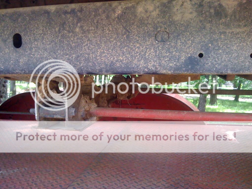

kiwipete Posted July 6, 2009 Share Posted July 6, 2009 Have you any pictures of the front setup at all, from underneath? Link to comment Share on other sites More sharing options...

unccpathfinder Posted July 6, 2009 Share Posted July 6, 2009 wow that does drop them down quite a ways...that may not be so bad if you could make a new torsion bar that is about 2' long instead of 4'-5' so it could be tucked up a little closer to the front wheels and reducing a high center issue but I think the diameter would be significantly larger Link to comment Share on other sites More sharing options...

kiwipete Posted July 7, 2009 Share Posted July 7, 2009 Front setup on the pathy or from a yota? Both please. Link to comment Share on other sites More sharing options...
