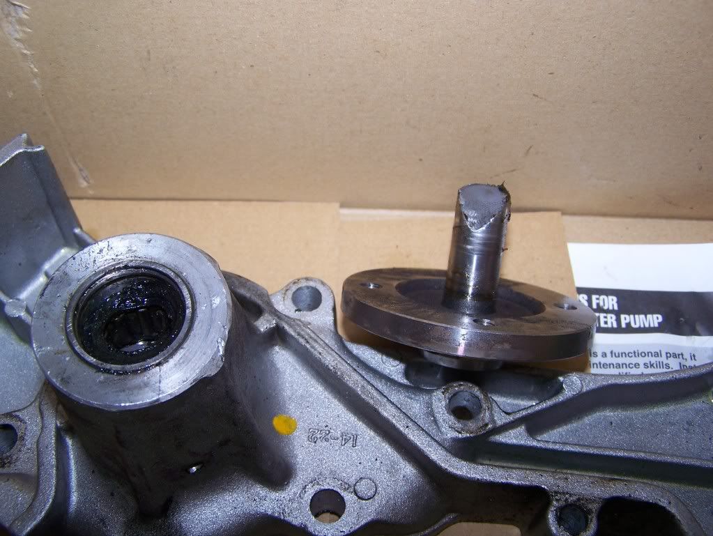

jimmaw Posted July 2, 2009 Author Share Posted July 2, 2009 (edited) Edited July 2, 2009 by jimmaw Link to comment Share on other sites More sharing options...
Precise1 Posted July 2, 2009 Share Posted July 2, 2009 Wow!! I see marks on the shaft, did the bearing seize?? B Link to comment Share on other sites More sharing options...
jimmaw Posted July 2, 2009 Author Share Posted July 2, 2009 (edited) Wow!! I see marks on the shaft, did the bearing seize?? B not sure its fine now, that is a bosch pump they actually did a recall because of this, and because of that my water pump and my new radiator were free! well not completly cost me forty bucks for fluid and time. Edited July 2, 2009 by jimmaw Link to comment Share on other sites More sharing options...
