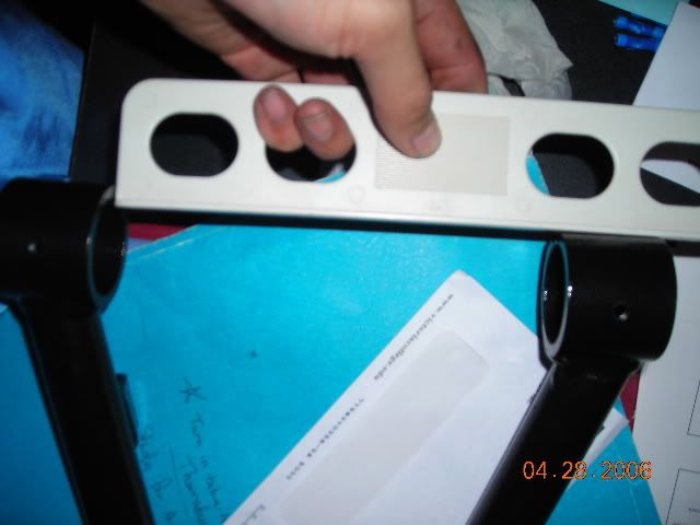

I just got my Rough Country arms. Reason I asked was when I opened it, I immediately saw that something wasn't right.
The rear driver side spindle tuble is not welded straight. It's not straight with the front driver side spindle tube.
The pictures show what I'm talking about. The second picture shows it even more. The bushing and spindle is centered in the rear driver side spindle tube. In that picture, the opposite end(far end)--which is the driver side front-- show's how bad it is.

I think we need a second opinion from someone else that's recently upgraded to these UCAs. I wouldn't go pressing bushings into them before you check with rough country or whoever made those.
You may have gotten a bunk set of them. You should pm or email 88. I think he has the exact same brand

Here are some pictures of mine showing the differences between each side of both arms.
Arms are upside down in all pictures and with the exception of the first picture the rest are taken from the same side of the arms.
Sorry for the bad lighting :shrug:

My Calmini arms were straight across, the spindle bolts slid right into place throught the bushings. The old stockers are also straight across, just looked at them. That doesn't seem right Cuong, but I'm not sure if it will matter or not.
Called Rough Country today, but since they are awaiting a shipment the tech had none that he could pull from the shelf to look at and compare. Instead he gave me SuperLifts number and had me call them. Said that if they agreed that there was a problem then he would exchange them no problem (when shipment came in and he could inspect to make sure they were not the same as mine)
Called Superlift and talked to Jason, walked him through what the problem was (he pulled a set of arms to compare) and agreed that there did seem to be a problem... the ones he had were straight according to him. Since I did not have the part number he requested that I call back with it so that he could verify that Rough Country had received the proper arms and not old outdated stock (if changes had been made to their design). He gave me two options, first one was to pay for a set then send the old ones back, once received they would credit payment back to my card. Or, send my old ones back and they would send me a new set once they had the old ones. He just needed the part number so he could issue me a return authorization (that may have been a "make sure he has them for real" move... but it does not realy matter anyway). This is the option that I chose.
However, I missed him by only minutes when I made it home and had the part number ready. Will call them back in the morning, and report back to you all tomorrow afternoon.
FYI, I also let him know that I am not the only one with arms that are like this, so they are likely going to look into the problem :Aok

Called them back today with the requested info, which of course was not of any help to them as the part number on the box was Rough Country's and not Superlift's. And these arms do not have the part number stamped on them as he said the Superlift branded ones do.
Anyway, he authorized a return for me... just dropped them off at the UPS Store (they go out tomorrow). The arms I get back will be the Superlift versions.
When I called him back I gave him tinyurl links to the images of my UCA's posted above, when he saw them there was no doubt... though he did have to go check on them because he had never seen arms of that color (I did not ask when he returned but perhaps RC coats the arms after they get them).
After I was done with Superlift I called Rough Country back and let them know that Superlift agreed that there was a problem and since Rough Country had referred me to them, they issued me a return authorization directly. I also suggested that they check the arms in the next shipment that they get and gave them links to the images as well, which they eagerly took all the info on this that I had :aok:
Looks like they might have been pulled out of whatever jig they use before laying the final beads and heat warped screwing with their alignments (or someone knocked the jig outa wack and no one caught it). Either way, makes you wonder about quality control if they were sent out like that.
