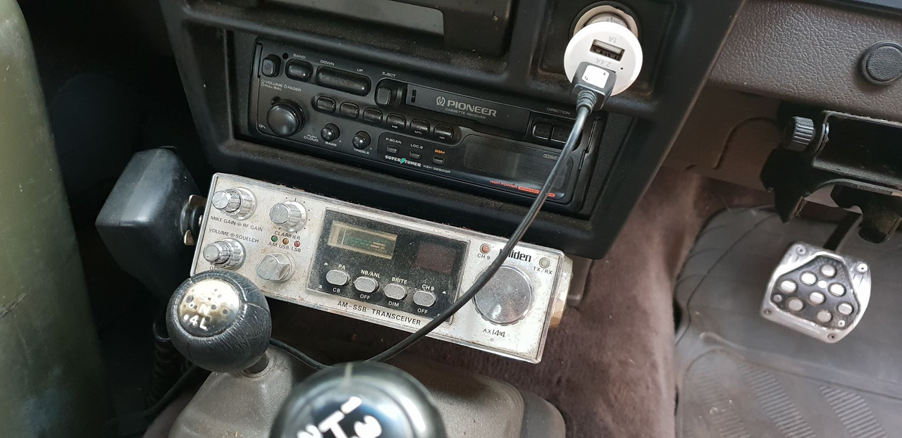

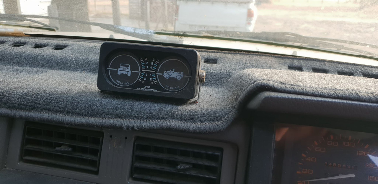

Went up to our property for a day and in between working on the house tinkered with the car for a couple of hours.
Removed all of the 'old man' add-ons

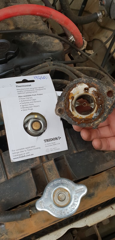

Also found the culprit for my overheating issue
83122137-2548400158765382-70232657365796
Threw in a new water pump and radiator at the same time, went for a run, cool as a cucumber!

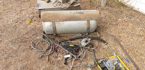

So I got up to our property a couple of weeks ago and removed the LP Gas tank and the auxiliary fuel tank that was fitted.
92240234-240055854055466-413891775960816

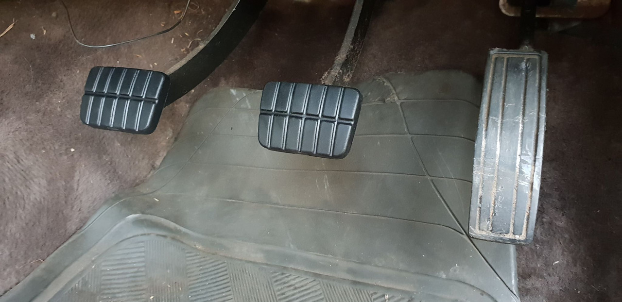

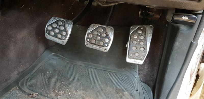

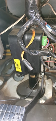

In addition I got up under the dash and cleaned up all of the old 90s add-ons and the LPG wiring. Was a great feeling removing all the dodgy splices and re-taping the loom like OEM!
Got rid of this car alarm too

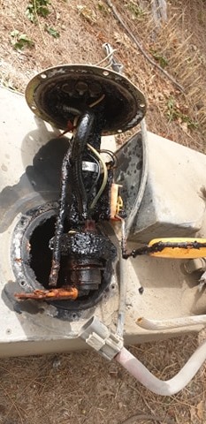

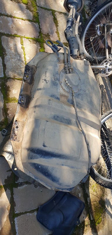

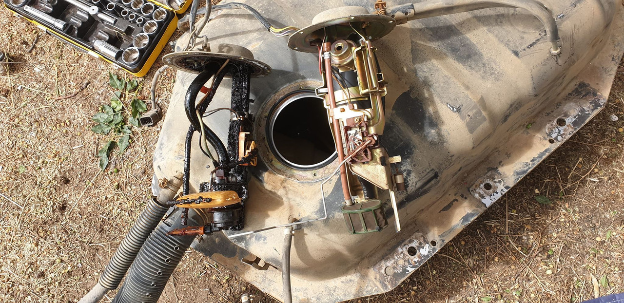

Pulled the sender out of the tanks, thinking I'd just use the OEM one out of the aux tank....
Now I should have expected this, as the PO told me the car had not been ran on petrol for over 10 years...
91902039-464198837633398-222783479811670
91848729-943767952705141-499206295511472
Not sure if you can quite imagine the smell, but think of varnish mixed with stale red wine.
Anyhow, OEM tank is fitted but waiting for a factory Z24 low pressure pump/pickup assy, which I now have as well as a good carb for it

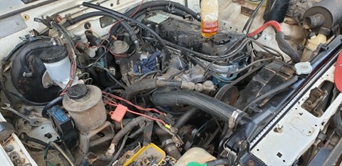

Replaced fuel sender/pickup unit, blew all the varnish out of the fuel lines.
Fitted a new carb, new fuel hoses front-to-back.
94400039-319514592375590-382318184166221
93853269-684475565648805-120888094274407
Fired straight up and with the timing adjusted idles like a swiss watch.

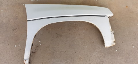

Found a 2wd D21 king cab at my local wreckers (interestingly I very nearly bought this car about 4 months ago, now I've got a few bits off it for the WD.)
Snipped the bottom off the RH guard to help in my repairs, should get the repair done over the weekend.
94434864-1080680285649382-61522947689372
94362638-1489927167841381-91451736274260

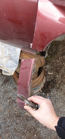

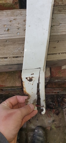

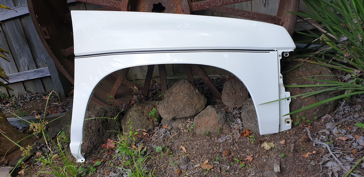

Repaired the guard today, cut the section out of the D21 2wd at the wreckers
94276843-255588112493992-150673762050637
94241076-293349428325103-818708262832360
For those that didn't know, the 2wds have smaller wheelarches which means the bottom of the guard is about 1" wider
- last time I did this repair I just cut straight across above the lower bodyline and welded the whole bottom on. In this case I had to section it down.
Welded in, light skim of filler and a coat of generic rattlecan white...
94188048-684136535745372-268394453235715
Now it's ready to go back on the car next time I'm up at the property, which will be after lockdown at this point.
94247431-687351508758609-393572938518469
I'm pretty happy with it.
Till next time stay safe out there
-FGF
Edited by FirstGenFreak
