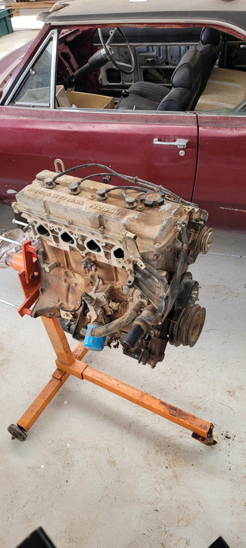

I've also found a machine shop to build the engine, so I will be getting the core form my parents house in a few weeks when I next make the trip in to Melbourne.

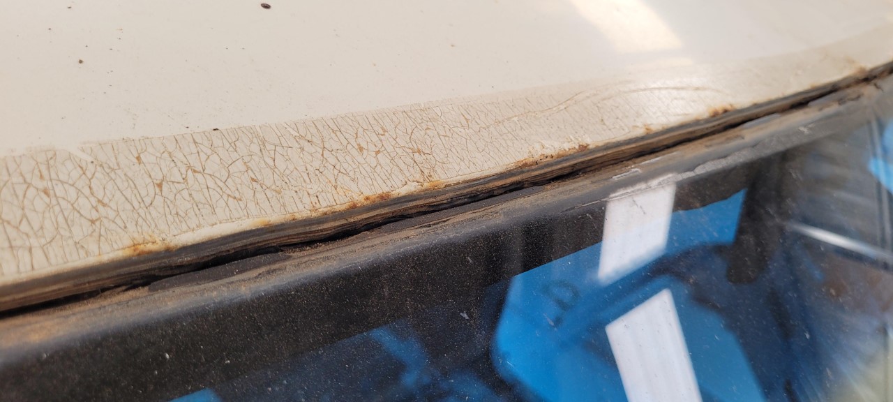

I found a bit more rust at the top of the windscreen, it looks to be surface rust only but I'll be pulling the screen to have a better look in coming days, but not today or tomorrow as it's 41 degrees Celsius here today (106 F).

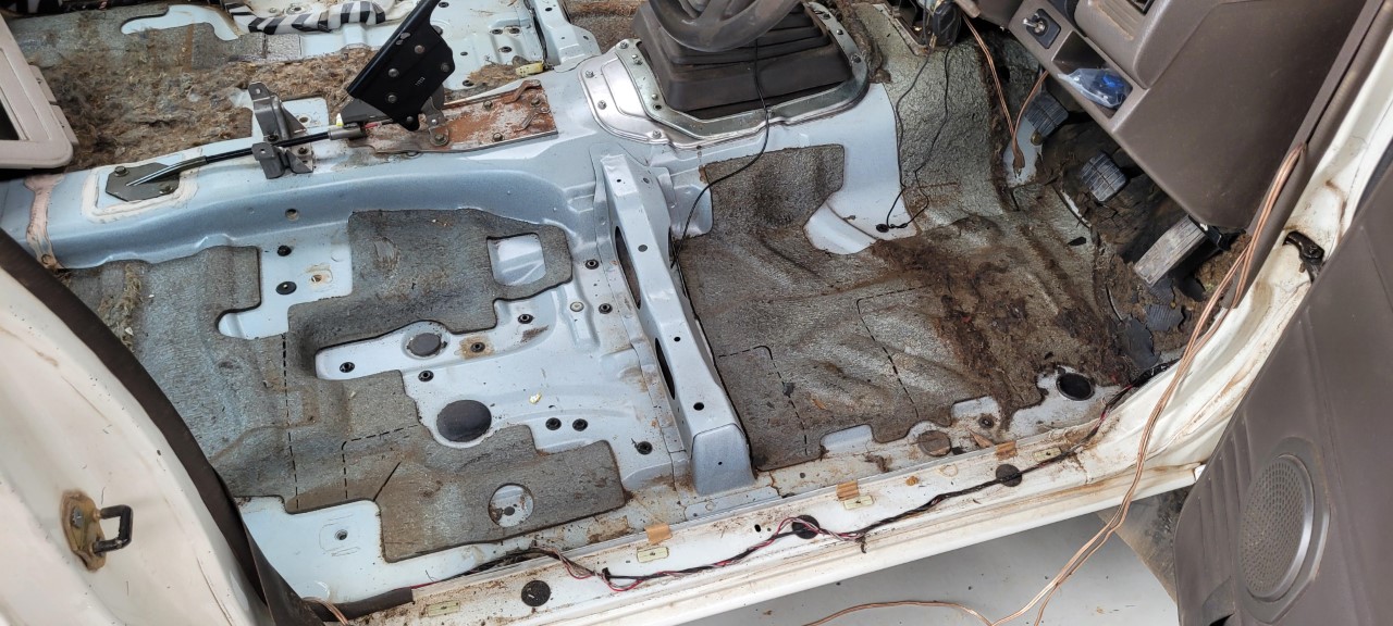

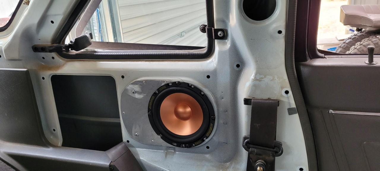

Pulled the seats and carpet to a. have a look at the floor and b. run new speaker wires and fit some newer rear speakers.
Gotta love these inland Aussie cars. How's that floor!

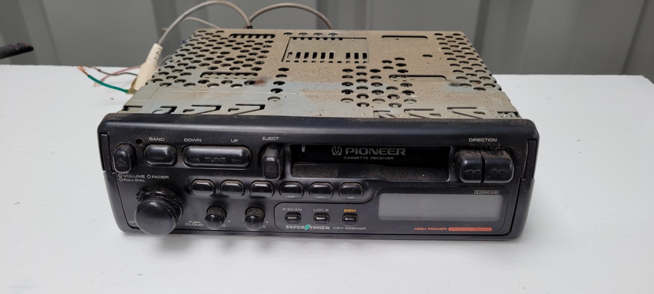

Got rid of the 90s tech

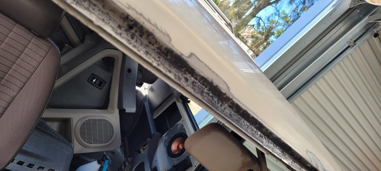

So I mentioned a couple of posts ago that I noticed some rust stains around the top of the windscreen. My OCD wouldn't let me leave it alone.
Windscreen needed replacement anyway, so out it came.

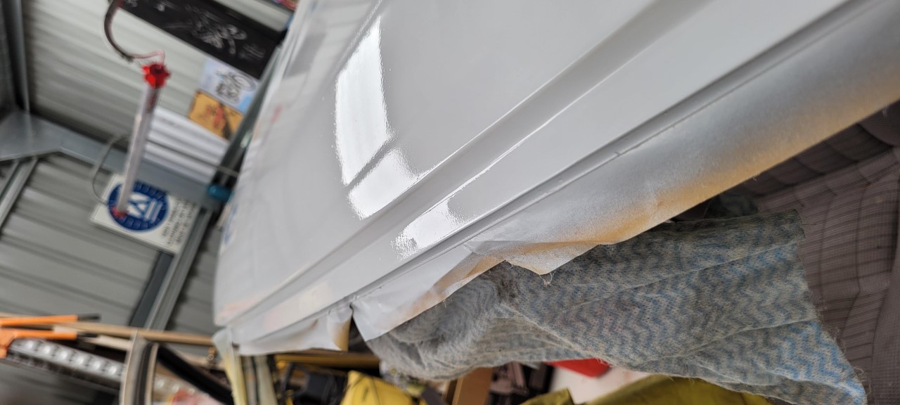

Far better than I was expecting, some minor pitting and scale, all cleaned up and hit with rust convertor.
Another sand and some primer
Coat of generic rattlecan white and a coat of clear
After that was done I filled the inner quarters and sills with fish oil, I do this to all my cars.

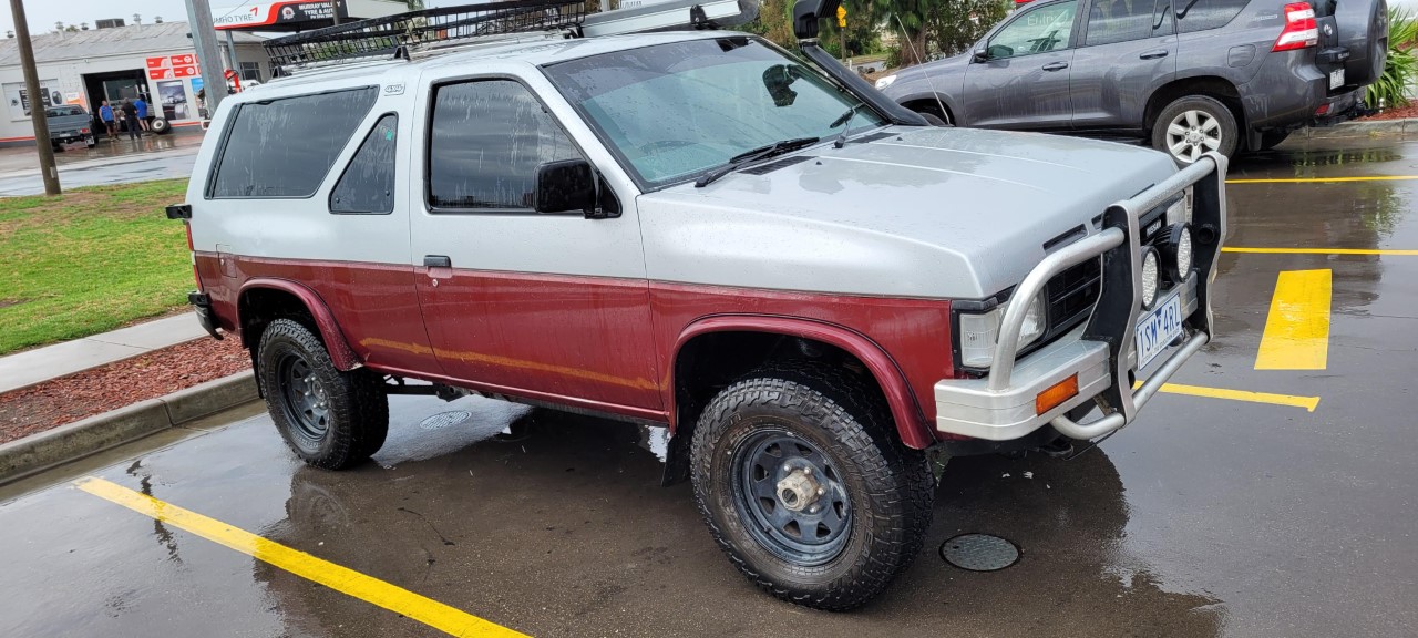

Cheers lads! Leaving now, wish me luck!
400km trip each way made for a long day.
Just after fueling up for the drive home:
Some Silo art we stopped to admire on the way home, this is only about a month or so old and has been on our list (Silo art is a big thing over here, we have the "Silo art trail" which brings a lot of tourism into small dying towns.
Annnnnnnd
Safely back home.
Car ran great, wound the old Z24 right up in the back roads and even overtook several cars!

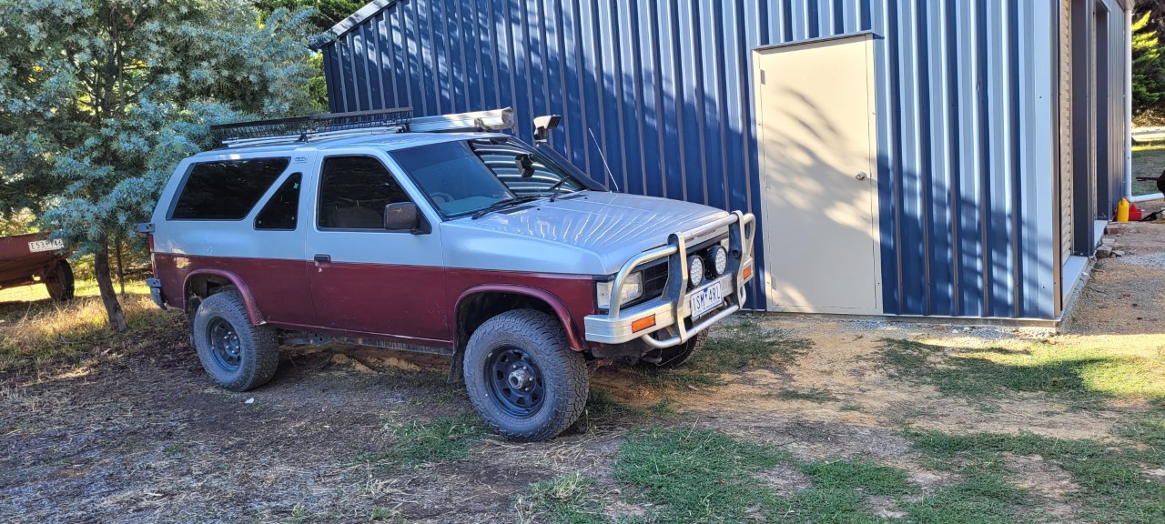

It's basically the same shape as when I had it except the wheels have been changed out for a smaller set, the gearbox is a bit noisy, some of the interior plastics are a bit knocked around and the wiring for the stereo has been hacked (PO had a sub in the back, obviously ripped it out in a hurry). Overall I am thrilled to have it back, but probably paid a premium for my sentimental attachment.

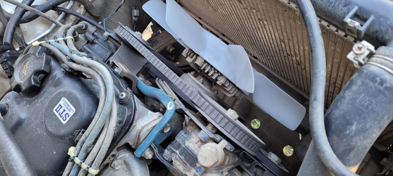

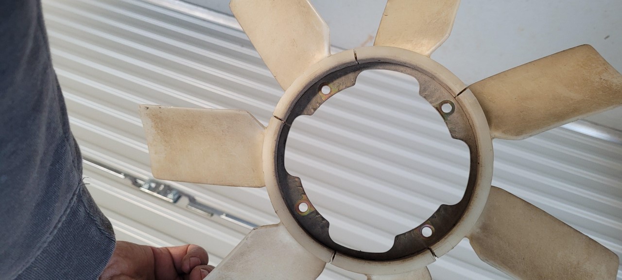

Checking the oil about a week ago I noticed all of these cracks in the engine fan:
Probably not too far off letting go!
Found a new OEM blade, not an easy part to find these days, although I am sure there are other 80s nissans that could donate a 2nd hand one.
Another job ticked off the list. Next is to build a battery tray and get the 2nd battery back in (another thing the PO removed) and fit my fridge/freezer in the back.
