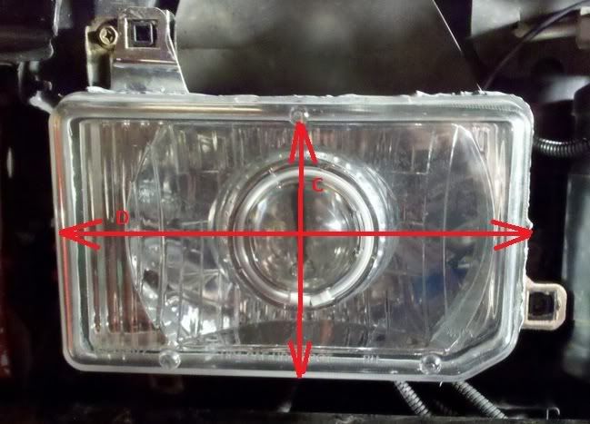

Hi Edicer2,
Loved your HID setup. The light output is quite impressive. I plan to do something similar
myself and hope you can help me out. I need the following dimensions "A", "B", "C" and "D"
please:
Note: I will need "A" and "B" dimensions without the gap ;)
William
Hi William I will try and measure that for you might he hard now with the grill and brush guard back on there. C and D are the same size as the OEM headlights but ill measure them anyways I will also get the measurements for A and B
