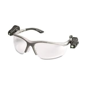

As for safety glasses, I'm a machinist and when I'm under the car, this is how I roll... :D

those the bluepoint saf-t-specs line?
http://www.amazon.com/AO-Safety-97490-Vision-Glasses/dp/B000S97ZW4
I highly recommend them!!
