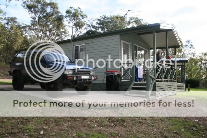

A pic of the villa we stayed in at Wangi Caravan Park .
A good few days of GF's Family and fishing with the girls .

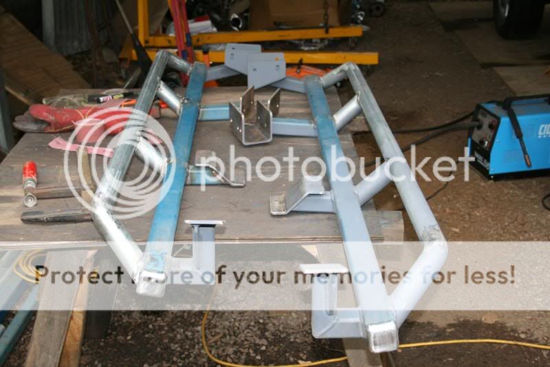

Sxc truck Cyril
Who did you do those slider for? I would like them to take some more pics of mounts if possible. Can you pls organise?

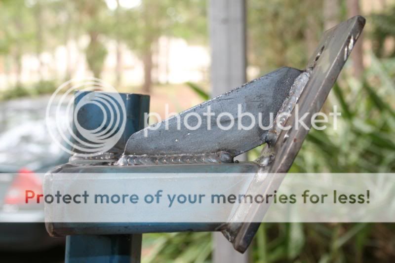

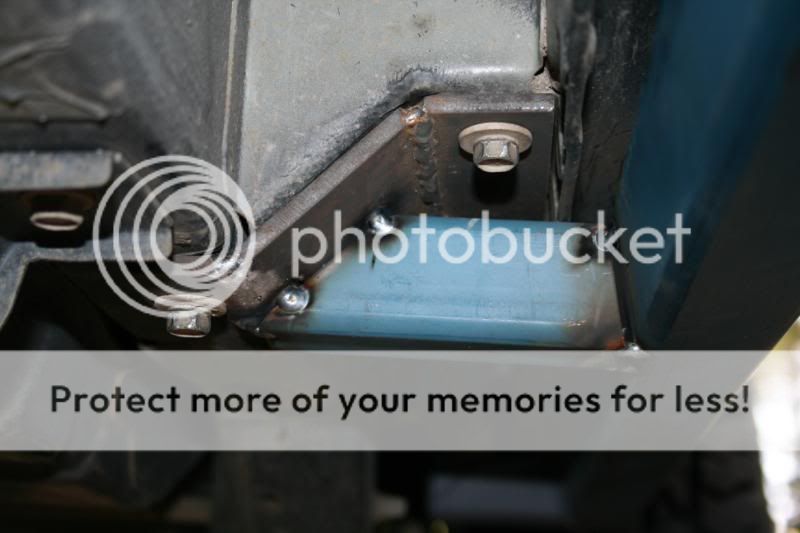

His name is Jason .
Will add some pics for you as i haven't heard from him in a while .
A Slideshow of the painted finished product .
http://s954.photobucket.com/albums/ae28/JA55EE/Cyril-Sliders/?albumview=slideshow

Were the 40 x 40 mounts snug under the sill seam?
Nick
The main Sq was 50 x 50 x 5 and buy using the 40 x 40 it gave a 10 mm drop to give the clearance of about 8 mm for a little flex if hit hard so it doesn't damage the sill .
