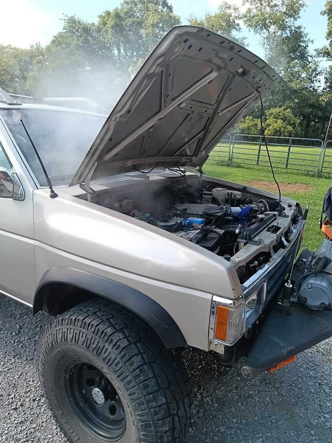

i always get rid of the spider web of stuff under the intake. my fix are these large thick vacuum caps you can get at a local part store.
Been running my woods truck like this and just did the r50 i got.
unfortunately in this picture you can see where i left my hose clamp off on the heater hose lol
