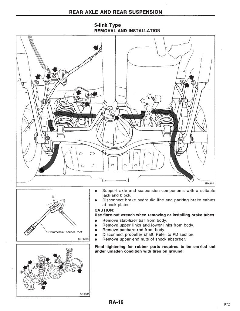

Another fantasy of mine: "True Dual Exhaust" with a 3" or 2.5" Pipe
What are your recommendations?
Is there a risk running the 2nd pipe too close to the RIGHT of the Fuel Tank?
The below is only a 1st trial layout for the route of the 2nd pipe. I probably need to
bring that muffler closer to the front to have more maneuverability in routing
the 2 final exhaust pipes:
William

Based on the views and opinions on this TOPIC, I'll go ahead with this project as follows:
1. I'll replace all the RED-marked pipes with a 2.5" diameter pipes
2. I'll replace the YELLOW-marked stock Muffler with one from FLOWMASTER (Please recommend a model/size!)
3. I'll keep the GREEN-marked pipe as is 'cause that's where the O2 sensor goes! Right?
4. I am considering replacing the BLUE-marked stock Catalytic Conv. (The Magnaflow one is nice but pricy!!!), What do you think?
5. I am puzzled about the remaining PINK-marked pipe. It is rusty and should be replaced. Can I put a regular 2.5" pipe in its place?
What do you think?
