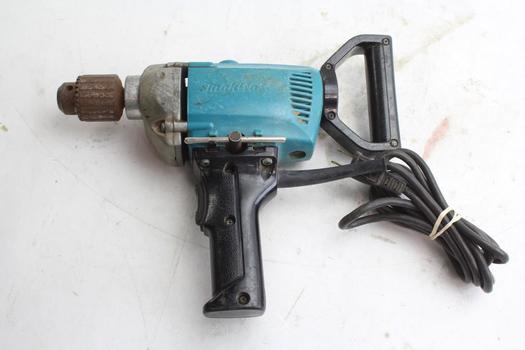

I had one of those big makita hand drills. Thing is a beast and it will tear your arm off lol:
makita-6013br-12-in-reversible-electric-
