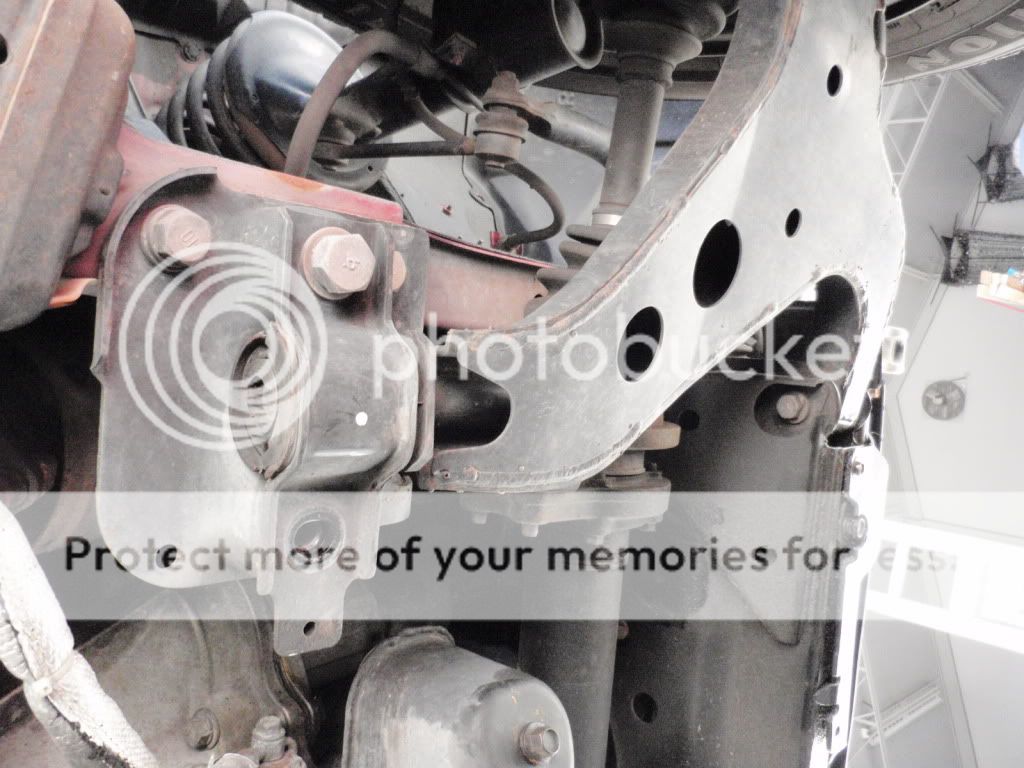

passenger side lower a arm mount with bolt out, 1-1/2" inch square tubing is the biggest that will fit
bolts out on both sides
I reused the bolts (long enough.

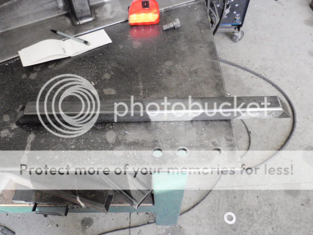

1-1/2" square tubing at 23-3/4" is what I used. I decided to just cut the tubing at angle instead of welding two mounts to attach it, which increase's strength
Drilling 9/16" mounting hole

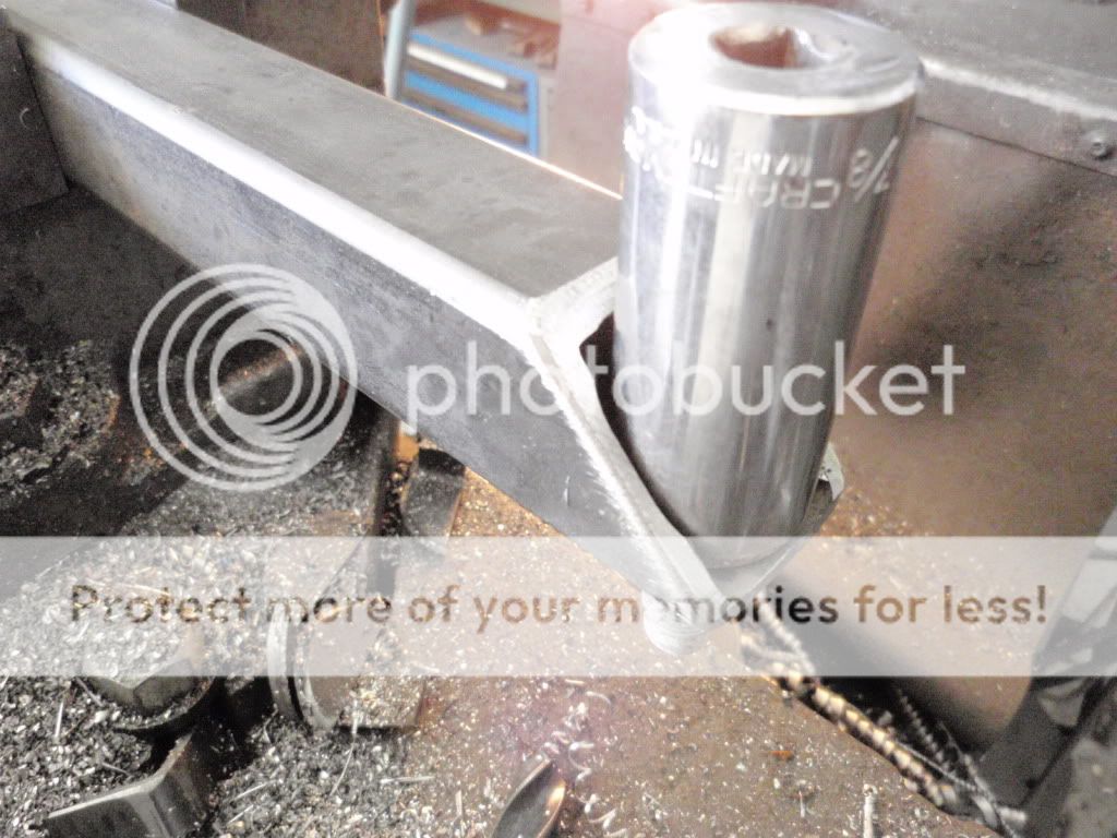

test fit of the cross-member, upon tightening I noticed I couldn't fit the socket in
Milling out a small amount of material to clear the socket, as so in the picture below

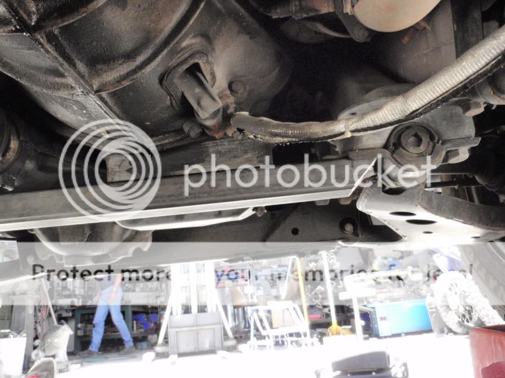

I then remounted the crossmember to make sure it still fit and tightened fully and went for test drive. I did notice right off the back that body roll was reduced
