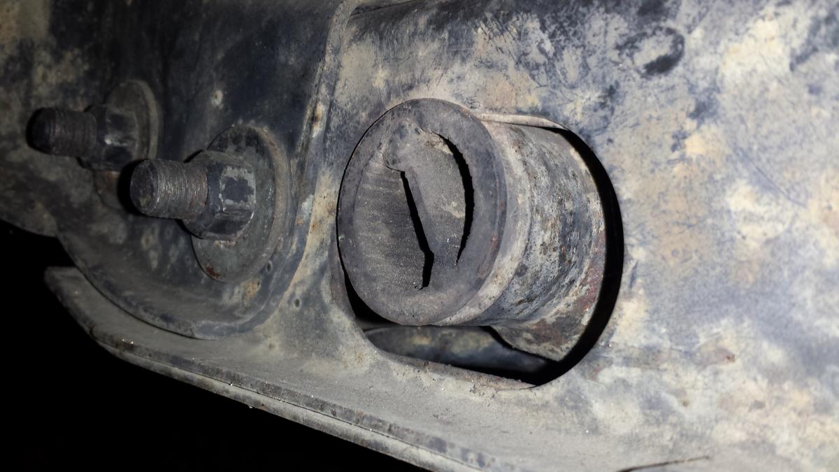

This just happened to mine, for the second time. The first one I was at a trail and thought it was caused by some bumps over rocks.
Now it happened when I was going to work. I've just heard a large CLANK and the truck sat like a lowrider on the driver's side, while the passenger's side is lifted :/
I didn't have time yet to check if the anchor or the tbar is stripped.
Edited by flnl

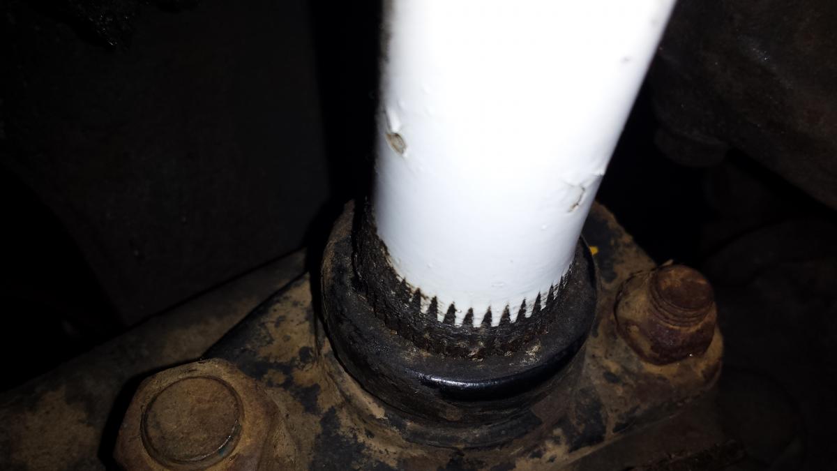

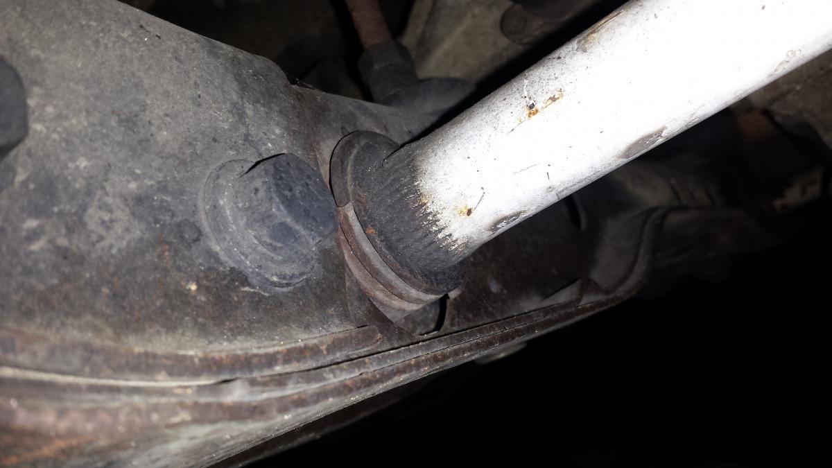

I just went out and took some shots of mine for comparison :aok:
To me it looks like your adjuster slid back and took the TB with it.
If you look at the rear shot of both my your adjuster and mine you will see that frame crossbar is sitting in the groove at the end of the adjuster, while yours is not. My guess is that you do not have the C-Clip on the front/TB side of the adjuster (See second pic above)
Also take note of the difference in the amount of threads visible at the front of the TBs/LCAs.
The C-Clip is there. But the splines of the front anchor are stripped just as FUELER's photo. I guess it was improperly installed by the guys that rebuilt the tranny.
I'm gonna check some JY to get "new" ones.
