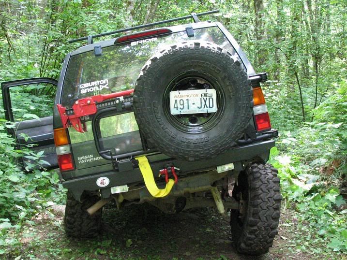

I modified my rear tire carrier with for a couple of reasons. First of all I got sick of my rear tire dragging when I climb very steep inclines and second to clear room for a double gas/water can set up next to it. The picture shows what it looks like after the fact but I basically cut out the original mounting plate, took off the piece that the tire mounts to (the bolted on piece) and welded it all the way on the top one gap over from the stock location. Its not too noticable of a mod but I haven't dragged my spare for awhile and as soon as I save up the 30 bucks for a couple of gas cans from the local military surplus shop I'll have them mounted.
