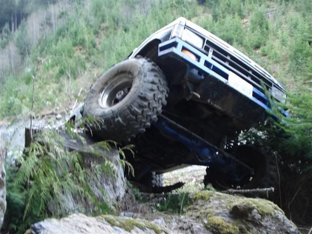

87pathy Posted April 24, 2007 Share Posted April 24, 2007 Doing SAS is a waste of money IMO but some people like it.I have not seen one pathy that is sas'd and doind some serious rock crawling.Why in the heck even do an SAS?but hey its their rig and moneyI dont think mudding and occasional pebble crawling calls for some SAS. Id rather spend my money and make my truck look like this I read this and laughed out loud and i'm all by myself. No real rock crawling eh? Ok, i'll stop.. get the idea.. oh ya, 90% nissan. Only the axles and suspension are not Nissan. Stock engine, stock tranny and 3.7:1 T case gears in a stock T case. Link to comment Share on other sites More sharing options...
