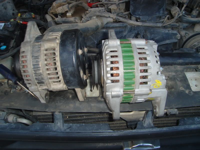

The process to install the new alternator is pretty straight foward, and a direct bolt on. First thing you want to do is look for your donor, the alternator that would fit into your 86-95 pathy would come from a 85-94 maxima. Make sure that you are getting one from SOHC maxi and not a DOHC, especially with the later year maxi's. Here's the diffrence:
As you can clearly see the mounts have diffrent angles. The other between the two is that the DOHC generates 5 more amps than the SOHC.

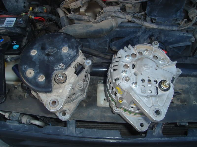

This is the diffrence between a pathy alty and a maxi alty:
The maxima alty is slightly more beefier than the pathy. Ok, if you decide to get your donor alty from a J/Y, then having it tested out at autozone or checker is recommended.
