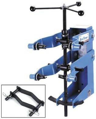

3 hours ago, RainGoat said:
[this is from one of our threads - it’s not mine & I’m happy to credit whomever if somebody can tell me who]
LOL. That's a photo I took the first time I had to replace my struts, sometime around 2000-2001. It was the first and the last time I used those spring compressors! Shortly afterwards, I bought a used Strut Tamer.
Edited by XPLORx4
Holy sh*t @XPLORx4, that Tamer is a beast!
Aside: How in tf do you get an image in the post? I searched, I tried, posted a URL instead of the image. Sad (funny?) thing...I'm in tech industry 😞
I’ll tag it as yours in the future. It’s very handy & I’ve sent it to many members who were very happy to have it.
