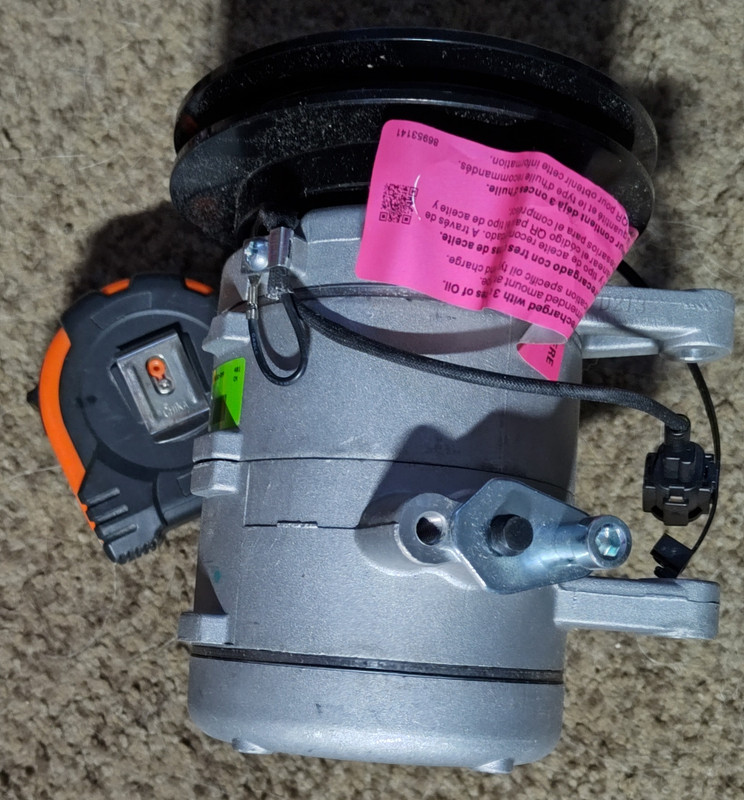

PamPoovey Posted June 2 Share Posted June 2 (edited) What I have received from two different manufacturer attempts through RockAuto and had asked for a pic from someone on Ebay and they all were this: It is missing the secondary wire that comes from the back area. I attempted to attach that pic what is in my 95. Any suggestions? Ideas. The plug on the attached image above is similar to the large plug that is "bolted" down in the stock photo below. Edited June 2 by PamPoovey Link to comment Share on other sites More sharing options...

level9 Posted June 7 Share Posted June 7 Mmm. Hard to tell from the pics but most likely you have the trigger + wire on one connector and the ground - on the other (grounding the compressor elsewhere) - confirm in the FSM. In order to save money and increase compatibility across different makes/models, aftermarket suppliers will sometimes just ground it to the case (and on through the engine block). In this way the compressor will work on both single plug and dual plug models - at least in theory. It will probably work fine if you just connect the connector with the + trigger and leave the other disconnected. Alternatively (what I would do) is cut off the ground connector from the old compressor and butt splice it onto ground wire on the new compressor. Link to comment Share on other sites More sharing options...
PamPoovey Posted June 7 Author Share Posted June 7 Thank you for the information! I am not that experienced with electrical. I get what you are saying. I re ri Ed my 4th incorrect one yesterday. After talking to customer service, which I did before I even placed the order and they still sent me the wrong one -this new customer service claims they were able to verify themselves and that I am receiving a misboxed one. They say they're shipping me a replacement next day shipping. Link to comment Share on other sites More sharing options...

PamPoovey Posted June 11 Author Share Posted June 11 Strike 5 with the wrong wiring Link to comment Share on other sites More sharing options...
level9 Posted June 11 Share Posted June 11 I checked the FSM for a 1995 and I only see 1 wire/plug for the + trigger and it's grounded through the case. Are you sure there are 2 plugs on the car ? Link to comment Share on other sites More sharing options...
PamPoovey Posted June 11 Author Share Posted June 11 There is only one to plug into my Pathy but there are two on the a/c unit. Just like my original post. I am not crazy, it is exactly what has always been there since I've bought this Pathy in 1999. Link to comment Share on other sites More sharing options...

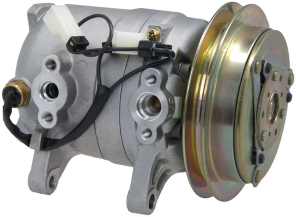

PamPoovey Posted June 11 Author Share Posted June 11 5 hours ago, level9 said: I checked the FSM for a 1995 and I only see 1 wire/plug for the + trigger and it's grounded through the case. Are you sure there are 2 plugs on the car ? https://www.discountacparts.com/buynow/60-01276_NC this is what mine looks like, except it's got bearing issues and it's about 10yrs old Link to comment Share on other sites More sharing options...
level9 Posted June 11 Share Posted June 11 I did some digging around and I think I understand the issue. The extra wire/plug is for the internal compressor thermistor which on the 2 plug version is serviceable (can be replaced separately). This is how the original OEM design was - I checked all years. Newer compressors typically have the thermistor built in and it is not serviceable; hence you won't see the extra plug. So as long as you can get a version with a compatible plug, it should work fine. If you can't find one with a compatible plug and you don't want to deal with electrical, just do all of the other related work and have a friend or mechanic splice on some new automotive grade connectors to the car+compressor - it shouldn't cost much. Link to comment Share on other sites More sharing options...
PamPoovey Posted June 11 Author Share Posted June 11 I appreciate the time and effort you put into trying to resolve my issue. So the new one has a large plug. The original has a large plug that plugs into something on the compressor, which then feeds the wire that has the plug that fits on the engine side. Am I understanding that I can cut off the large plug and take the old small plug from the previous compressor side and splice that to where the large plug is on the new compressor so it will be able to connect on the engine side? Link to comment Share on other sites More sharing options...
level9 Posted June 11 Share Posted June 11 (edited) 48 minutes ago, PamPoovey said: The original has a large plug that plugs into something on the compressor, which then feeds the wire that has the plug that fits on the engine side. Yup. The 'something on the compressor' is the thermistor (screwed into the back/side) which turns off the compressor to prevent overheating. It looks like a single plug aftermarket version will simply have this built-in so you won't see it. Some digging around indicated manufacturers started moving in this direction (built-in thermistor) some years ago - likely due to lower cost and increased reliability of the thermistor so it didn't need to be easily replaceable. I'll wager a guess if you order a new compressor for an older car at this point it's probably a toss-up which one you'll get (internal vs. external thermistor) which is probably leading to the confusion. I originally thought this was an extra ground wire since there is already a high/low pressure switch cut-off located at the receiver/dryer (which, btw, you are "supposed to" also replace whenever you replace a compressor) but apparently there is a local temperature switch as well (internal or external) - you learn something new every day ! 48 minutes ago, PamPoovey said: Am I understanding that I can cut off the large plug and take the old small plug from the previous compressor side and splice that to where the large plug is on the new compressor so it will be able to connect on the engine side? Yeah - what I would do (since I don't like altering the car/engine side wiring unless absolutely necessary) is cut off the plug on the old compressor that connects to the engine wiring harness (leaving at least several inches of lead wire of course). Then cut off the new compressor plug and then just butt-splice the old connector onto the new one. Make sure you get a really good crimp on it - there are a lot of amps moving through this connector and you don't want a poor connection. Of course this will likely void the warranty. So before I did that I would test fit the compressor and hose connections to verify fitment. I would also bench-test the compressor to confirm it works (search youtube). Isn't DIY fun? I also poked around to see why your connectors don't match up. It looks like Nissan changed the connector type at some point. My '90 Pathfinder has the white/clear (well - yellow at this age) large blocky connector which is also likely creating confusion in the aftermarket parts market. Edited June 11 by level9 1 Link to comment Share on other sites More sharing options...
