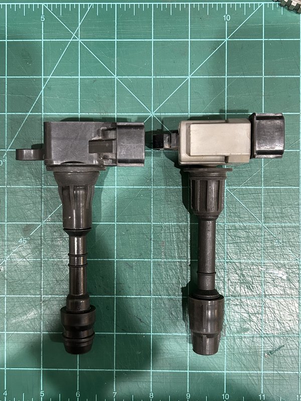

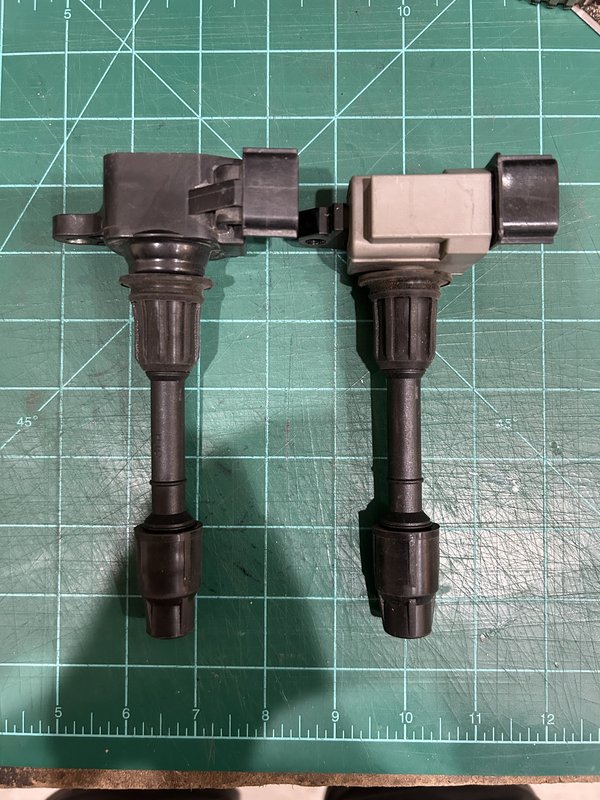

Dbot Posted February 4 Share Posted February 4 Can metal ones be found? Yes. Junkyard 2001 R50s have aluminum valve covers. You'd want to replace the spark plug tube seals and you'll need to change your #1 coil for a 2001 R50 #1 coil. It's longer than the other 5. Also, I suspect that G35/350Z valve covers should fit the heads and somebody could get creative with the rubber hose and wire harness locations. 350z/G35 variant of the vq35de use the same part number for the contoured valve cover gaskets. Below is a comparison between G35/350z aluminum valve covers (red) and aftermarket pathfinder valve covers (black). Link to comment Share on other sites More sharing options...
hawairish Posted February 5 Share Posted February 5 4 hours ago, Dbot said: 350z/G35 variant of the vq35de use the same part number for the contoured valve cover gaskets. Yep! Valve cover gaskets between a bunch of VQ35 and VQ40 vehicles are the same so that's a pretty good sign they'd all fit. The covers do look like they'd fit, but only takes 1 or 2 dumb Nissan changes to throw things off. That rear-pointing tube on the driver's cover would be a problem. Link to comment Share on other sites More sharing options...

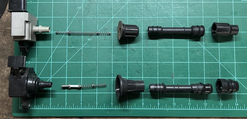

hawairish Posted February 11 Share Posted February 11 (edited) For sure you'd need an older #1 coil. For the other coils: 2a: It's possible to swap the boots older-->newer, but you also need the spring 2b: You'd need to lengthen the boots, which would prevent spark plug contact, so this is a no-go. 2c: Since the older coils were intended for the older covers (aluminum), this is the most correct route. That's what the guy did in that Nico post (man...I barely had the truck 2 years when I was chiming in on that...how things have changed). That said, I did some R&D for you... Newer coil on left, older on right. When aligned by the mounting tabs, the older is about 1/2" longer. When aligned by boot length, they are the same length. The older coil's mounting tab sits above the plastic valve covers mounting hole by 1/2". As mentioned earlier, you can probably still fit the newer style in cylinders 2-6, but the coil has to be turned enough to avoid the mounting boss on the aluminum covers. You could possibly use a screw and washer in the boss to retain the coil to some degree. Taken apart, you can see all the parts are different. Although the spring in the older unit is quite longer, it sits deeper in the hole in the module. All the tube parts are shaped differently enough that fitment isn't great if you were to swap things around, but it's somewhat possible. With springs in and aligned by mounting tab, the older coil is still 1/2" longer. If you put the older style boot and older spring onto the newer style module, the boot fits nicely and everything else seems to be the correct length and position. Not that it matters here, but the newer boot will not fit the older module unless the top of the boot is cut off. Now, since the springs are different, I have no idea what impact it has switching it. I also don't know if you can get the boots and springs. I'd say that if you're at a junk yard and pulling them, you may as well just buy the complete coils. Although my personal opinion is that the additional cost to do this project doesn't really have much ROI, unless it's just cheaper than buying new plastic covers. Hope this helps. Edited February 11 by hawairish 1 2 Link to comment Share on other sites More sharing options...
