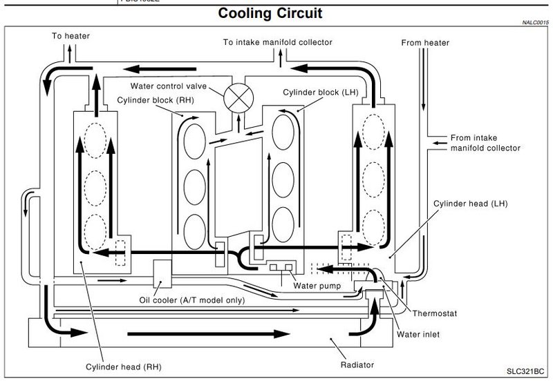

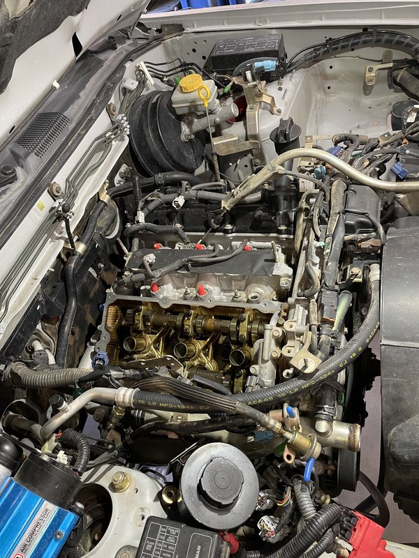

hawairish Posted December 28, 2022 Author Share Posted December 28, 2022 Yeah, it's a silly code. The reason I don't believe there's an air pocket around the temp sensor is because the sensor and water control valve are on a crossover pipe that runs between the heads and has an output that wraps around the passenger side of the engine to the upper radiator hose, which exits higher than the crossover pipe. In the pic below, the sensor is by the dragon logo, and the WCV housing to its left. The Y-pipe by cylinder 3 runs to the heater core. The heater core return line is the black pipe running along the firewall. The little vertical tube with a rubber cap on it is the vent tube That is the high point of the system. As such, with enough drives (I spent a good chunk of Monday driving around to perform the drive patterns to get the truck emissions ready), I'd expect any air to roll out of the crossover tube pretty easily. The only place I'd expect trapped air at this point would be at the WCV on the intake plenum side if the coolant did not reach 203F to dump it into the crossover pipe and circulate it. Air on that side is inconsequential, though. Full system flow: Breather tube is on the "from heater" line. "To|From intake manifold collector" runs through the throttle body opening. I do have a radiator funnel and was using it exactly as you mentioned. Ran the truck a few times and let it sit. Eventually when I determined the vent tube was clogged and drilled it out (the tube and pipe is steel, so I'm guessing the persistent coolant level over the years just corroded where sat), I still had the funnel attached and about half full. I could tell coolant was circulating somewhat because crud I couldn't vacuum out eventually surfaced in the funnel. The thermostat is actually a triangular thermostat housing assembly that can only be installed one way; the thermostat part of it isn't replaceable, but yes, the valve was upward. Mine has a water inlet port for the oil cooler on ATs. The WCV is a normal thermostat shape, and it's installed flat; it's installed in a manner that allows coolant to flow across the thermostat body without being obstructed by the supporting vanes (as described in the FSM, no less). Everything said, I have also not seen any leaks whatsoever. All gaskets replaced, tightened to FSM spec. I was throwing these 3 codes: P0128 - this mess P0171 - Bank 1 fuel injection system too lean P1148 - Bank 1 closed loop control (faulty passenger upper O2 sensor) Part of my overhaul in August included new spark plugs, reconditioning the fuel injectors (cleaned, new o-rings, new pintles, new filters), and replacing all 4 O2 sensors. Long story short is I've been having all sorts of fuel/O2 issues since the overhaul, which is blowing my mind since I set out to prevent all these issues and chase some other code that popped up once a year that I can't recall. I just tore the engine down again (four times in as many months?!) maybe 2 weeks ago to troubleshoot all 3 codes. My thought process, given all the codes, is that if the passenger bank was in fact running lean, then maybe half the engine wasn't getting hot enough. The spiral seemed a faulty O2 sensor causing lean condition causing insufficient engine heating. P0171 suggests a lot of things, including a leak in the exhaust; that seemed the most plausible while other suggestions seemed implausible. There's a massive backstory bull$h1t fiasco regarding trying to replace the catalytic converters during the overhaul and even up to last week, but let's just say I finally replaced the gaskets on the cats. I'll note the passenger cats and exhaust manifold were very sooted over...a far cry from a too-lean condition, but possibly sooted from when I was initially dealing with a rich condition months prior. I also pulled all the plugs, injectors, and coil packs again, cleaned everything again, and moved them all around to different positions. The code has not resurfaced. P1148 was pretty specific to the upper passenger O2 sensor. I monitored the voltages on all the sensors with my scanner over the course of several drives and observed that the nominal voltage for it was not fluctuating as it should per FSM. All other sensors were fine. I'm still bitter about having the most difficult sensor to replace be the one that failed. The other 3 are easy. Replacing this one sucks tremendously and basically requires pulling the cats. New sensor is functioning as expected. Code has not resurfaced. One additional notable: I installed an aftermarket transmission cooler during the overall and initially ran it in series with the OE cooler built into the bottom of the radiator. I eventually bypassed the aftermarket cooler and reverted to using only the OE cooler when dealing with some other performance issues that surfaced. I still threw the P0128 code in the stock configuration. Just the other week I hooked the aftermarket cooler back up and bypassed the OE cooler. All said (and sorry for a long post), only P0128 persists now, fortunately. I was scrambling to get it emissions ready because my tags expire at the end of the month. The P0128 code resurfaced as Pending code on the drive to the emissions station, which fortunately doesn't prevent passing. As far as I can tell, the system is finally in top shape (my test drives on Monday were yielding 14-15 MPG, which is worlds better than it has been and pretty solid for my configuration), so this code feels like a lot of tail chasing. I may just block part of the radiator and call it a day. What I'd really like to know is if I can just tweak the coolant ratio to reduce efficiency so the temp will be hotter. Link to comment Share on other sites More sharing options...
