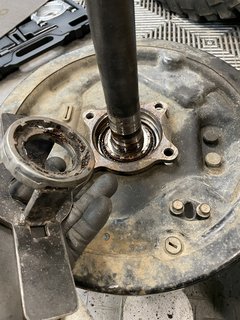

Slartibartfast Posted April 3, 2022 Share Posted April 3, 2022 The R50 drum/WD21 disk rears are built the same, but the drum WD21 rear is a different beast with a single row on either side and the axles butted up against a thrust block in the diff, with shims on either side to set the end-float. I did the rear bearings in mine recently (WD21, disk) and there isn't really an adjustment for them. Just a very high torque spec for the nut that holds it all together, which I'm not sure how you're supposed to get, given that you'd need the world's deepest socket or a really weird crow's foot to get a torque wrench on it. I just gave 'er wha by hand with the spline wrench I welded up to remove them. I've seen people use a hammer and punch instead, but I didn't want to risk damaging the stupid spline nuts. And, yeah, you'll need a press and some creativity in setting it up for the various operations you'll have to do to get everything separated. The service manual has a pretty good breakdown, though of course it assumes you have the super-special Kent-Moore kit for everything. Too bad it has to come apart for a seal, that's a lot of screwing around for one piece of rubber. But if there's oil coming past the outer seal, that suggests the inner has been whupped for a long time. If you're going to the effort of replacing the seal, I'd plan on doing both seals, the O ring, and the bearing as well. Mine weren't actually bad (much to my annoyance--I was hoping they were the source of an annoying noise) but they did show some discoloration on the rollers and races, and there wasn't a whole lot of grease in there anymore. Looked like the inner seals failed and diff oil washed the grease out. I also had to put a fair whack of stress on the old bearings to get the axle to budge. This didn't leave any obvious damage, but I was happy I had new bearings that hadn't been abused like that to put it back together with. (And then there was the race I dropped, where the plastic cage broke and the rollers scattered from hell to breakfast.) I shot some video of the job when I did mine, then never did anything with it. Let me know if you get stuck on something and I'll try and work out what I did there. 1 Link to comment Share on other sites More sharing options...

gamellott Posted April 3, 2022 Author Share Posted April 3, 2022 (edited) @Slartibartfast Ya, that torque spec is crazy. I have been doing some research on how one would do this and I believe an OTC 7463 Gland Nut Wrench might just do the trick if the nut is not recessed. I have also seen a few shock spanners that might work as well... Worst case, Whack it with a hammer and punch. They couldn't simply make an octagonal nut with recesses in it. Ya need a special tool.... If there is a right one out there, what is it? After all, 30 years and 300Kmiles, and now it's leaking (Or I'm noticing it). There is a little bit of oil in the parking brake drum... When I first got this thing 8 years ago, it was leaking from almost every single seal, but it ran good. I've slowly been knocking out replacing the seals on everything, from the easiest to the hardest.... Next... the transmission and rear main, because they're leaking bad!!! The oil spots on the clean concrete are both dirty and clean oil Edited April 3, 2022 by gamellott I misread my manual Link to comment Share on other sites More sharing options...

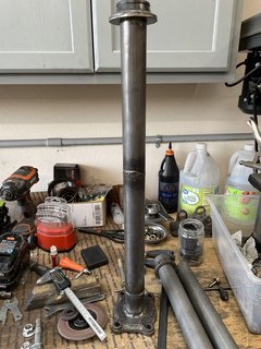

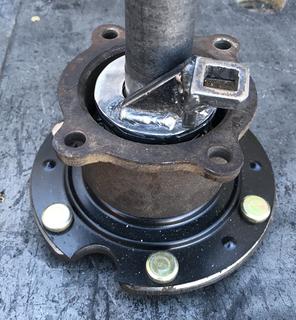

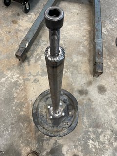

Slartibartfast Posted April 4, 2022 Share Posted April 4, 2022 The Rockauto system is usually pretty good. Nissanpartsdeal is my usual go-to for identifying parts and year ranges and whatnot. I ordered most of what I used from RA, but they didn't have the lock washers, so I bought those through Partsouq. I like those CNC'd sockets. Mine is not nearly that nice. I cut some strap steel to fit the splines, then welded them to a pipe to keep them in formation. I tried welding a bolt to it to use with the torque wrench, but, yeah, that didn't hold up so well. A sacrificial 1/2" drive socket would've been better, but by that point I think I had realized that my torque wrench didn't even go that high, so I welded on some rebar handles called that good enough. The drawings in the service manual call out PNs for some of the tools they suggest (though others just say "suitable tool"). I looked some of them up when I did mine and found what I think was the right kit, but the listing didn't have any pictures and it was priced stupid high. And yeah, I'm not sure what function the torque spec is serving here. It's not like you're gonna set preload given how tight those inner races are pressed onto the shaft. Maybe it's supposed to push the races home if you didn't get them fully seated with the press? It might just be a standard torque spec for that thread size and pitch for all I know. I bought a cheap press for mine (the cheapest Northern Tool had) and had to stack some wood under its legs to get enough clearance to get the whole axle in there. Worked great after that, though. I do like Towndawg's solution. 1 Link to comment Share on other sites More sharing options...
