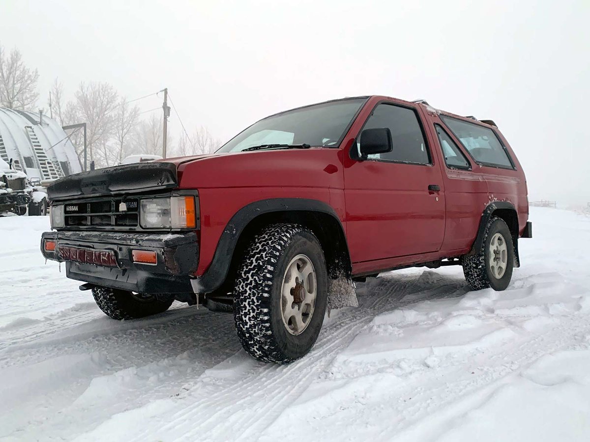

flickertheory Posted January 6, 2020 Share Posted January 6, 2020 Hi all! I've just acquired a beautiful 87 SE after years of searching high and low for the right unit, and I'm excited to be joining this community of fine folk. The truck has been barn-kept for most of its life and is in decent condition (79k km on the odometer), but I have my eye on replacing the bumpers and front grille. Anyone know if these later 90-95 WD21 parts will fit an 87? Chrome/silver? The compatibility searches on RockAuto seems to think not, but I figured best to take this to the true experts! Link to comment Share on other sites More sharing options...
Jeristair Posted January 6, 2020 Share Posted January 6, 2020 Yep, I've done this conversion on my 88 Navara with a 1990 Terrano. I had to drill 4 or so holes in the front. two for mounting the guards and two for the replacement headlights, but other than that I had no problems. My 88 Datsun originally had the small lip bonnet so I had to swap bonnet, guards, grills, I think bumper is different, headlights and corner lights Link to comment Share on other sites More sharing options...
nend Posted January 6, 2020 Share Posted January 6, 2020 Hi, welcome to the group. The newer type bumpers will fit you '87 pathfinder. If you decide to replace them i might be interested in your old '87 bumper... Link to comment Share on other sites More sharing options...

nunya Posted January 10, 2020 Share Posted January 10, 2020 Direct swap for the grill, bumper will require the proper bumper to frame brackets (to match the bumper year) but will bolt directly to the frame as well. If doing a D21 grill/headlight setup you will also need headlight buckets, wiring pigtails and side markers. Again aside from the headlight plugs is all bolt on as well Link to comment Share on other sites More sharing options...
flickertheory Posted January 10, 2020 Author Share Posted January 10, 2020 Great tips, thanks @nunya! Interesting to know the D21 grille is such an easy swap. I'll definitely be investigating that more too... Link to comment Share on other sites More sharing options...
