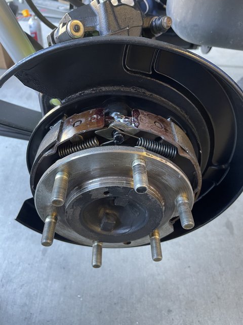

Finished the parking brakes on the Frontier today!  I'm very pleased with how it turned out, far better than what I did on the Pathfinder.
The other night I determined that the 300ZX brake kit wasn't going to work.  The return springs were too short, as were the anti-rattle pins.  Figuring that if the Passport parts worked, maybe a kit for the Passport would work, too.  The kit arrived today and worked out perfectly...so perfectly that I'd say 100% of the kit pieces are compatible with the WD21 brakes.
The parts on the left are from Carlson 17396 for the Passport (and several other Honda, Isuzu, and Acura vehicles 1994-2015), and the parts on the right are from Carlson 17418 for the 300ZX (and Q45, both 1990-96).  The kits differ by the return springs at the top, and the anti-rattle pieces in the middle (pins, round springs, and retainers).  The blue springs, red/orange springs, and adjusters are identical.  Everything from the kit got used (well, except the c-clip and spring washer...didn't bother, wasn't needed).  The return spring design is a little different from OE, but worked just fine.  The proof:

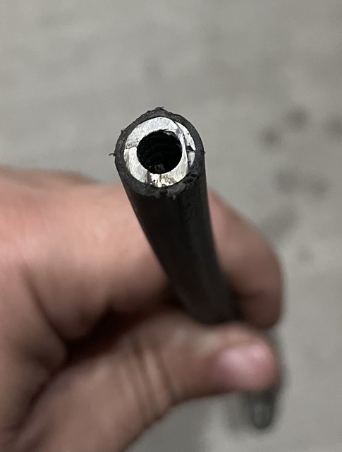

The parking brake cable is two main parts: an inner cable, and an outer sleeve.  For this approach, we're only splicing together the outer sleeves.  The inner cable remains fully intact, minus cutting the ends and crimping new wire stops on.  Before cutting the outer sleeve, make 100% sure the inner cable is pulled out of the way (cutting the inner cable in the wrong place is definitely not a good thing).  The rest of the cable is just rubber boots, tubes, and brackets used for protecting and attaching the cables to the truck.  Nissan uses compression rings to secure the rubber on the cable.
The outer sleeve is made up of a metal "tube" and a plastic/vinyl jacket.  The tube is actually a thick spring, which is why it's both rigid and flexible.
I recommend a Dremel and small metal cut-off wheel over other means.  An angle grinder with a cut-off wheel should work fine, but might be a little overkill.  Just be sure to not distort the core, since it is just a spring.  If needed, use a reamer, or jeweler's file, or other deburring tool to clean the opening, since the inner cable will need to pass back through without snagging.  The end should also be flattened (the piece in the pic was scrapped, so it wasn't cleaned up).
The cable has a 10mm outer diameter.  I initially tried a 2/0 AWG connector, but it was too loose.  The 1/0 connecter was a perfect slip fit, not loose, and not tight.

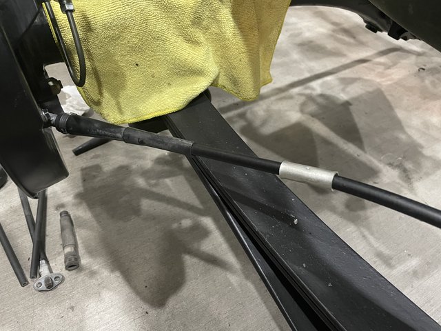

Start by mounting the WD21 cable to the backing plate.  Make sure as much of the R50 cable is routed and attached in its normal position along the trailing arms (in my case on the D22, attached to the frame and routed over the leaf spring).  Bend the WD21 cable to contour the original path of the R50 cable, then mark a suitable position on the R50 cable to cut (wrapping tape around it helps).  This should probably be about 6" from the R50 foot.  Make sure you also leave enough space to slide any protective hoses up the cable so they can be slid down after crimping.
BEFORE YOU CUT ANYTHING: Follow the cable to the middle of the truck, where they connect to the parking brake lever and tensioning mechanism.  You must pull the inner cable out enough so that it won't be cut!  You may have to pop a dust boot off of a mount to do so.
Cut the R50 outer sleeve only.  You may need to detach the cable from the trailing arms so that you have room to work in.  Once cut, reattach the cable to the trailing arm, again routing it in its normal position.  Bend the WD21 cable again to contour to the desired path, aligning it to the cut end of the R50 cable.  Check and double-check the cut position on the WD21 so that it'll meet up tightly with the R50 end, then mark the WD21 cable.  Detach the WD21 foot from the backing plate, then cut the sleeve.  It may be wise to leave a little extra on the cut, since the cable can flex if it's a little too long.  If it's a little too short, it could be a problem.

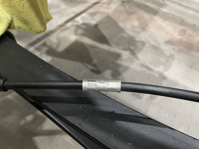

Once both cables are cut, you can confirm the lengths by slipping the butt splice connector on them.  Do not crimp it at this time; it's just a test fitment.  It should end up like this (well, similar...this is the D22 of course):
66-CD57-B4-8970-463-C-BBBA-B98337981-DB9
You can see in this pic the connector is not crimped and that I have already mocked up the boot at the end.  At this point, there's a bit of an order-of-operations.  You must have everything in place on the line before anything is crimped.  That means any boots, pinch clamps, the butt connector, protective hoses...everything must be in place first.  Once the butt connecter is crimped, nothing else can be added or removed to the line.  In my case, I left (or created) enough slack to slide a longer piece of tube that will get slid down.
Reattach everything to the truck.  Bolt the WD21 foot on the backing plate, and R50 cables on the trailing arm again.  Everything should be snugged up a little, too.  The reason is that the cable must be in its normal resting state with it's all crimped together, otherwise you'll hate yourself later.  You can also push the inner cable back through the sleeve from the middle of the truck now.  If it jams where the cables meet, you can move the cables around to guide it through.
Once everything is attached correctly and pieces are on the cable, you can crimp the butt connecter.  The hydraulic kit has a "50" and "75" die for 1/0 and 2/0. respectively, but a "60" would have been better here.  The 75 is too big, and the 50 too small, but the 50 needs to be used here.  Don't max out the 50 crimp!  Instead, feel for a stopping point on the hydraulic crimper before the dies meet—this is the point where the crimper is starting to apply excess pressure to the spring core.  I imagine the crimper could surely collapse the core, which would be a very bad thing.  So, crimp firmly, but carefully.  It should end up like this:

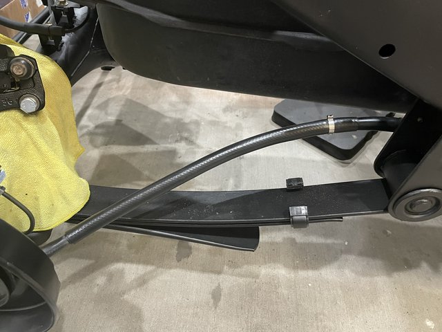

Keep pressure on the outer sleeve while crimping to ensure it stays fully engaged in the connector and doesn't create a gap.  At this point, you can slide down any protective hose over the connector, or crimp the pinch clamps on the boots or elsewhere.    Here's how mine turned out:
This is the RH side, but the LH side turned out almost the same.  Also, don't rely on any numerical measurements here when you change sides.  Just because you cut 6" on the RH side, doesn't mean 6" will work on the LH side.

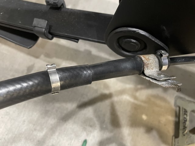

Despite all the warnings above, the only thing I forgot to do was put a pinch clamp on the outer protective hose.  Now...I put earlier notes that the pinch clamps were optional.  It seems like Nissan used the compression rings on the rubber parts mainly to keep moisture and debris out.  I'd say you could use hose clamps instead (I did on the LH when I forgot), but the pinch clamps were a nice substitute to keep an OE look.  I wanted the protective hoses clamped specifically to keep water out of the line and eventually working its way into the butt splice connector.  The ones I got from McMaster were perfect.  I imagine you could also use CV boot band clamps, but these pinch clamps were far easier.

  • Fully assemble the parking brakes (shoes, springs, rotor, etc.) on this side.  This is so you can confirm sufficient slack was taken up at the lever point.
