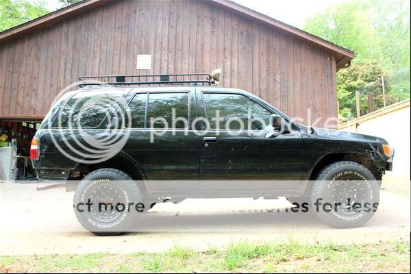

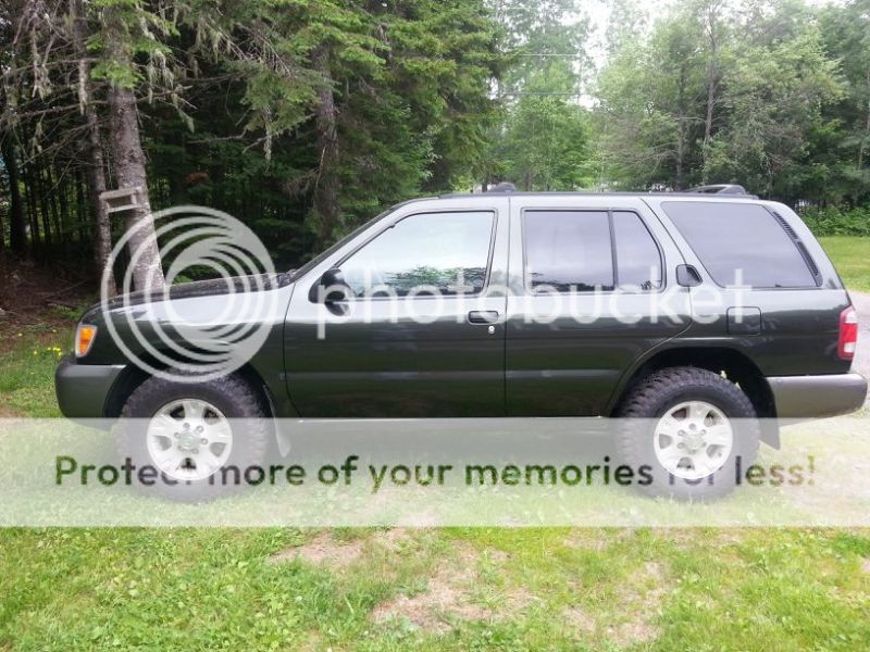

Also, while I'm learning all kinds of new things about the 4x4 world (had a TJ for a year once, so don't really have any experience) what is a good wheel tire combo? I'm looking for the soft 8's or sth similar, nothing out of the ordinary, and 31-32" tires, ideally MT. But what size width should the wheels be? I see a lot of them come with the option of 15x10 and I love the look of deep dish, wide offset wheels. But does that fit with just a 2" lift? Will this require more backspacing? Logic tells me yes, but I better ask anyways.
Below are 2 pics, sorry to whoever these belong to for stealing them, of what I'm looking to achieve, and I was wondering what I will need to be looking for.
Can't really say what's up with those two trucks , but they look similar to my set up height wise .
This pic shows a '96 XE ('99's are the same) with a 2" AC coil lift and additional 1" strut spacers in the front .
32" Cooper STT's on 15x8" Pro Comp steel wheels with 3.75" backspacing .
The coils were "fresh" in this pic , it's since settled a bit but not much....
In these pics you can see how the backspacing pushes the tire out from the strut perch , you can see how without flares they'll be past the fenders by a couple inches .
In some places it could cause legal issues , some people don't like the "wide look" .
