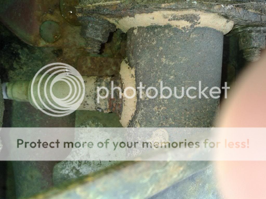

I recently replaced mine and this is what it looked like underneath...
I looked at that and literally said "$%^&, how is that coming out..."
I used a lot of penetrating oil... just spraying it on and letting it sit then repeating. Take your time if it is stuck in there it will eventually come out.
I also borrowed a tool from my cousin (not sure on the cost) that was an O2 sensor socket... slips over the wires and sits in there perfectly... made the task so much easier.
Once I got it to start turning (not an easy task) more penetrating oil and time... Came out fine once I broke it loose.
The new one went in so much easier than the old one came out.
