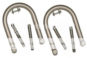

Would love some shots of how the hoop fixes on, as lookin at ideas for my front end :)
those are getting chopped off and put up higher for a better angle...you can order those same hoops from TG
