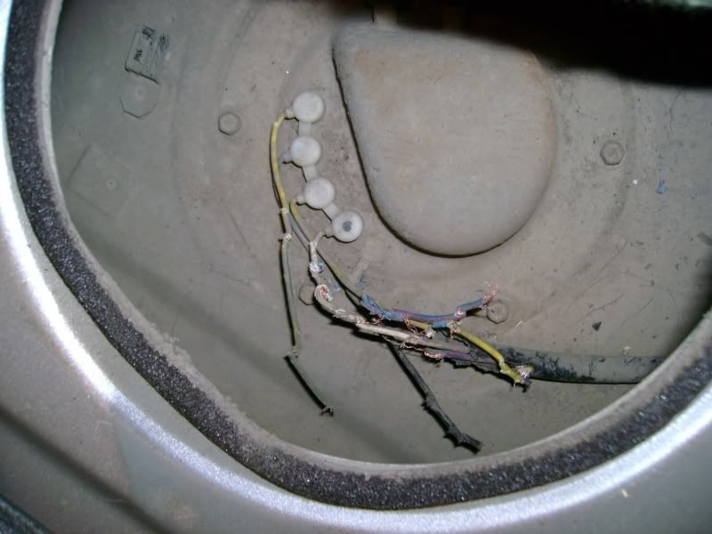

Mr. Pickles Posted January 9, 2007 Author Share Posted January 9, 2007 My guess is the wiring to your sending unit....had a similar problem a couple of years ago. The guage SHOULD move up with the key in the "on" position. That was my thought exactly, so I pulled the cover off and ta-da... freshly chewed up wiring. I'm talking mangled, and nice, clean and shiny. Its looks like something got in there and chewed it all up, maybe a squirrel or something. The truck ran fine Friday, then parked it until today (Monday) when the problems came up. Great... well time to clean that up and see what happens. P.S. I've got pics, but now the comp won't cooperate with either of our cameras. What the hell, this is definitely a Monday. Link to comment Share on other sites More sharing options...

Mr. Pickles Posted January 10, 2007 Author Share Posted January 10, 2007 If the wiring were unplugged, I suspect that the gauge would let the needle fall all the way. Exactly, it fell all the way to the bottom, below any level of "E" I've ever seen, like a quarter tank below E. That's why at first I thought it wasn't working when I hooked everything back up, cause I guess it was so low it needed a bit to rise up. But now all is well, I drove around today then filled up this evening, and everything is fine. I even sqeaked out 16mpg on the last tank of almost all highway. Between lift, tires, etc. I've been down to about 15hwy/12city. Here is a pic of the pretty hilarious carnage. Notice all the scratch marks. I guess they little buggers didn't like me. Link to comment Share on other sites More sharing options...
