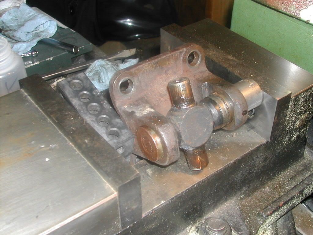

Precise1 Posted August 19, 2007 Share Posted August 19, 2007 Ok, so my universal joints started making noise driving home a week ago. Thankfully, I was 1 mile from home when I noticed it (not 200 miles away like the week before!). I've not replaced U-joints before; I suppose this is a How To write up but I'd like input from others to see what their method/experience was like. I'll clean it up and re-post it later. Oh, this is on a 95 V6, manual tranny; I'm not sure if autotragics are different. I'll start by saying that unless you have a decent garage set up and another vehicle or if you can spare a few dollars and have a shop you know/trust, just pull the drive line and take it somewhere, it's not worth the headache... The sound was far more frequent than once per rev of the wheels so I didn't think it was brakes, axles, etc but I checked them regardless as I haven't pulled the rear drums since I bought the truck 3 years ago. It was hard to tell where the noise was comming from as the drive line is one long resonance tube and the fact that the noise did not occurr with the rear axle jacked up/tires spinning/in gear/motor running. I felt a significant amount of slop in the rear U-joint and decided that it was the most likely source and needed replacing regardless. $30 for 2 U-joint assemblies at Autozone later, I pulled the drive line. Note 1) Clock mark the bolt flange at the rear differential. Some people use paint, I use a file as I've had the paint come off. While you are at it, clock mark the drive shaft ends to the shaft its self. You want to assemble it the same way... Unfortunately, my truck spent the first 2 years of life in Rodchester NY so it had a film of surface rust, annoying but not that bad. This makes removing a 12 year old steel/steel press fit rather difficult to break free. First thing I did was brush away as much grit/rust as possible, ring the steel (hit it with a hammer a few times, it helps break free corrosion) and soak it with penetrating fluid overnight (my new favorite is Croil:creeping oil). Note 2) The C clips are on the inside of the journals, make sure the replacements are the same and that you remove them and clean the bearing cup inside surface before trying to drive the cups out. Using an undersized socket (11/16) as a drift punch, I found I couldn't budge the cups what so ever. This is with the drive line clamped in a 6" mill vice mounted on a 700+ lb mill and striking with a 24oz dead blow hammer and 3lb hand sledge as seen in the photo. B Link to comment Share on other sites More sharing options...

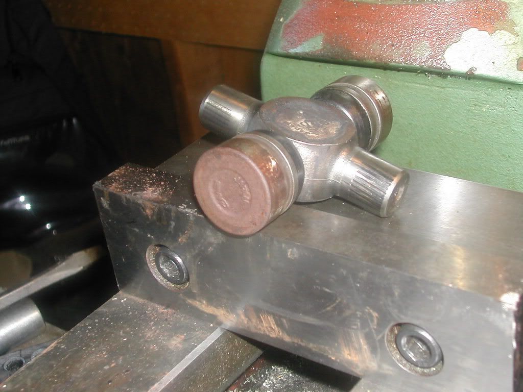

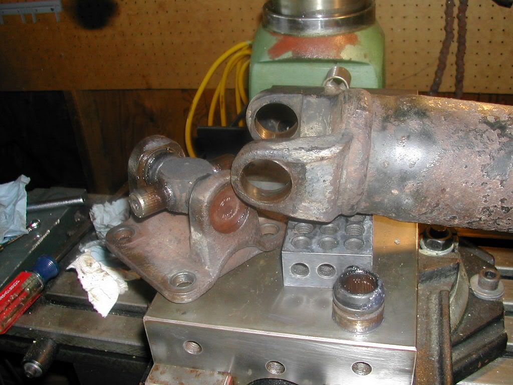

Precise1 Posted August 19, 2007 Author Share Posted August 19, 2007 Ok, hammering didn't work so I rotated the drive shaft 90 degrees, placed the socket against the vice jaw, blocked the other side so the cup had room to move and cranked the vice tight... REALLY TIGHT!! Nothing moved, even when heated with a torch. Ringing the steel was the trick, it finally broke loose. B Link to comment Share on other sites More sharing options...

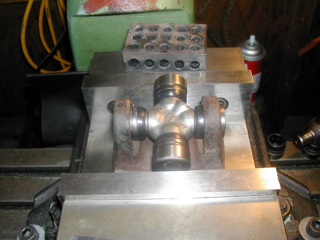

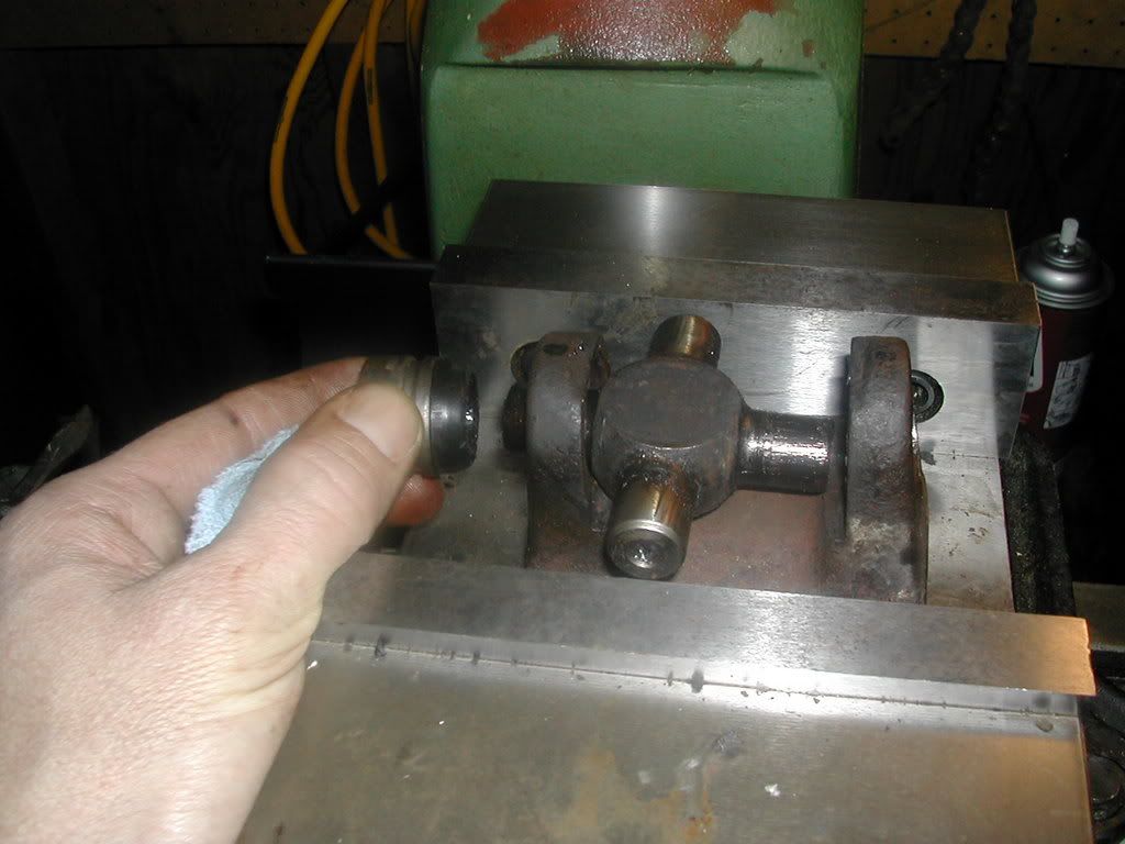

Precise1 Posted August 19, 2007 Author Share Posted August 19, 2007 Ok, now it was simple to drive 1 of the bearing cups completely out. Problem is that the cup on the other side was driven completely in and there is NO WAY to pivot the spider out with the cup on the end. Simply not enough room. Note 3) Be VERY careful with the journal inside diameter that the cups press into!! If you fugger them up badly, you need to have them welded and rebored or just a new drive shaft!! B Link to comment Share on other sites More sharing options...

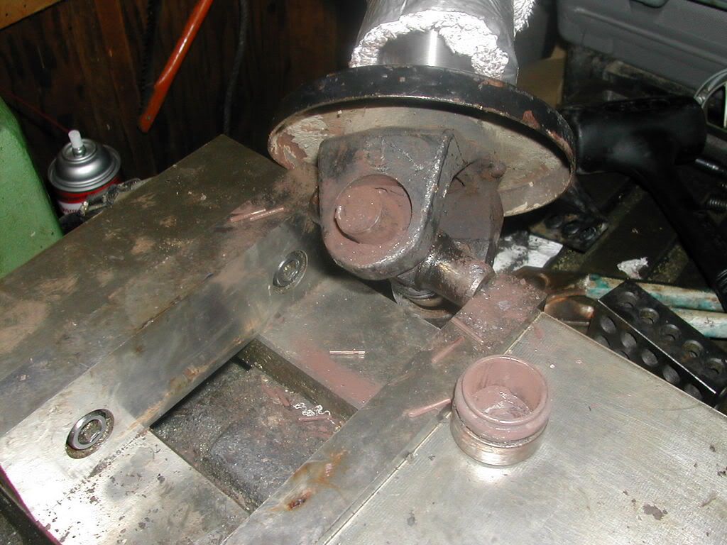

Precise1 Posted August 19, 2007 Author Share Posted August 19, 2007 This meant the remaining cup had to be cleaned, properly aligned and driven back through and out the other side of the freshly greased journal by striking the exposed end of the spider. I used a deep dish socket (5/8 or so) and a 24oz dead blow hammer. B Link to comment Share on other sites More sharing options...

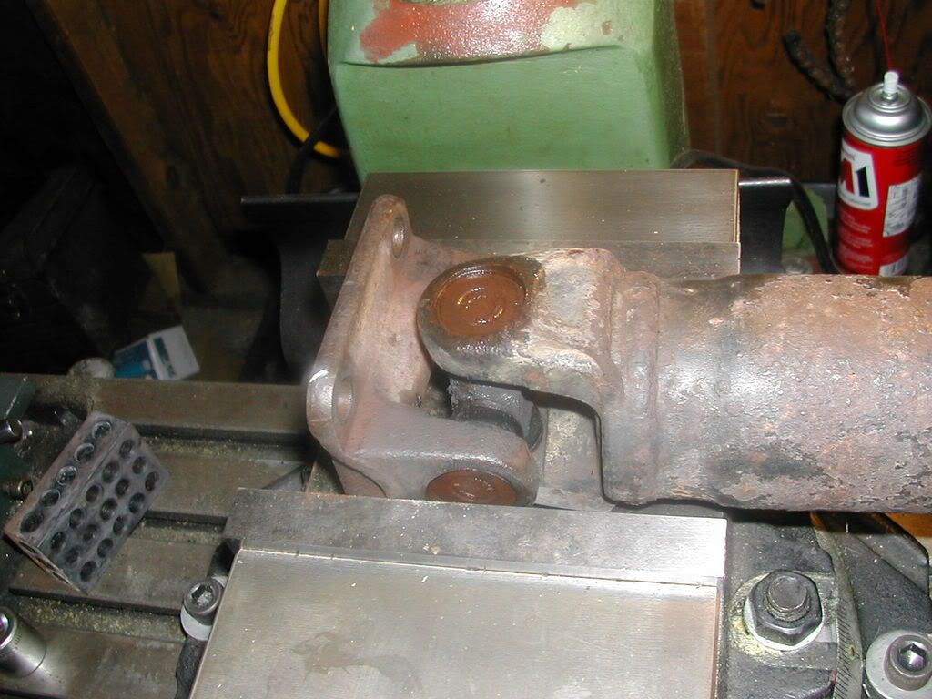

Precise1 Posted August 19, 2007 Author Share Posted August 19, 2007 With the second cap driven out the far side, the bolt flange with the spider is now removable. I opted to remove the ends first, then work on them as I thought this would be easier and I believe I am right. B Link to comment Share on other sites More sharing options...

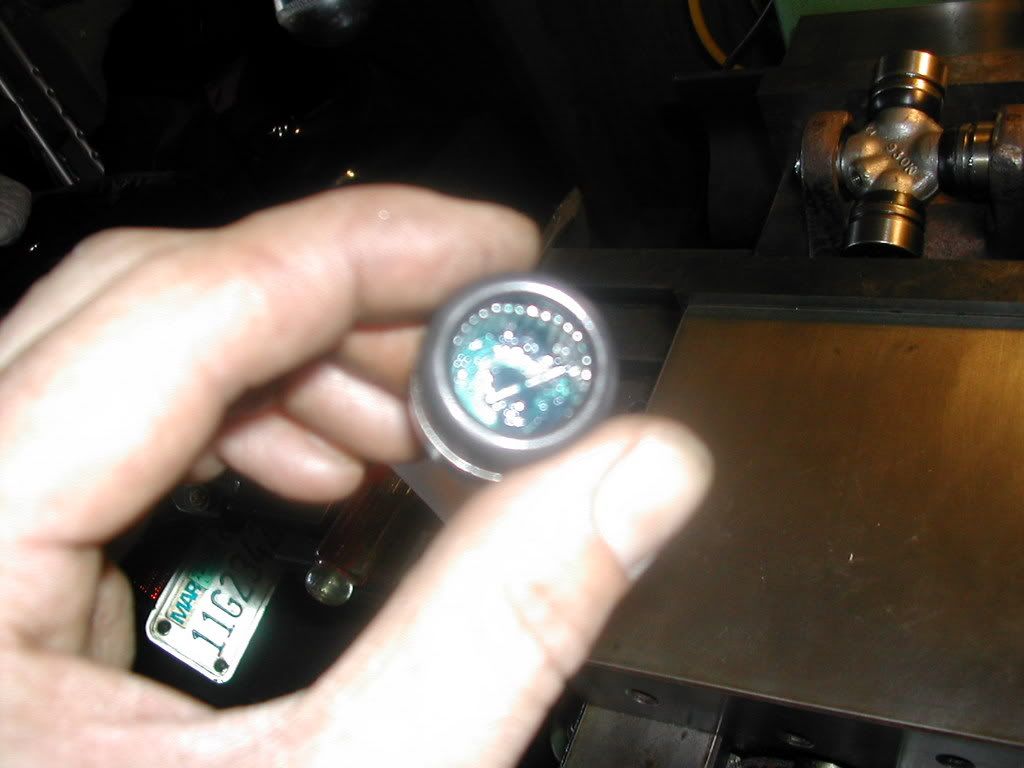

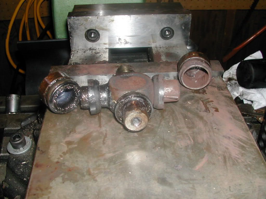

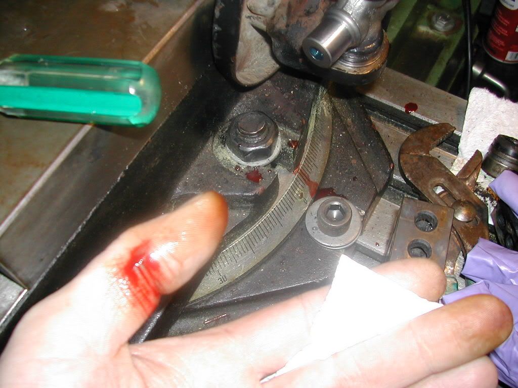

Precise1 Posted August 19, 2007 Author Share Posted August 19, 2007 Now it was just the same process using the vice to drive out one bearing cup, then cleaning/greasing the other side and driving that end back through. The spider is removed, bearing journals cleaned with steel wool and greased. Oh, my thumb no longer looks like that, but I'll explain later... B Link to comment Share on other sites More sharing options...
Precise1 Posted August 19, 2007 Author Share Posted August 19, 2007 This is what the spider journals looked like when cleaned. Holy Crap!! The scores are .02-.03"deep!!! No wonder it made noise?? Nope, that's the effect, not the cause. It gets better... B Link to comment Share on other sites More sharing options...

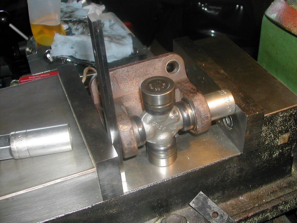

Precise1 Posted August 20, 2007 Author Share Posted August 20, 2007 Ok, this is the process of installing the new journals. Exact opposite of removal. The spider HAS to be inside the cage first, then the journals pressed in on either side. What a pain in the acks design!! Make sure to have the spider firmly seated in the side you are driving in first, or the needle bearings can be displaced/fall to the bottom sideways, like the photo shows. You'll know this happened when you cant move it the last little bit to secure the C clip, then everything has to be driven back out(did this twice). Extra grease globbed in the cup on the needle bearings seems to help them stay in place. B Link to comment Share on other sites More sharing options...
Precise1 Posted August 20, 2007 Author Share Posted August 20, 2007 Oh, I found it easier to set cup all the way and install the C clip, then press the other side until you can do the same. It took me various combinations of vice pressure, dead blow and hand sledge to achieve this... B Link to comment Share on other sites More sharing options...

Precise1 Posted August 31, 2007 Author Share Posted August 31, 2007 Ok, the thumb pulping occurred when I was working on the front U-joint, second in line. After I had finished the rear one on sunday afternoon, I installed the driveshaft with the idea that I would do the front one the next weekend. The rear axle was on jack stands, I started the truck, put it in gear and looked underneath. The rear end of the tranny was wagging back and forth more than I would have thought possible. Ok, no driving until the front one is replaced. Much to my suprise, I learned that it was the primary source of the failure. When I drove one cap off, there was a shower of rust and bits of needle bearings. As you can see, there was only one dry journal, but it was TOTALLY dry!! I know I have greased the U-joints twice in the 3 years I have owned the truck, but for some reason none of it got there. I haven't had the time to determine if the grease channel was not properly machined, blocked or whatnot. B Link to comment Share on other sites More sharing options...
