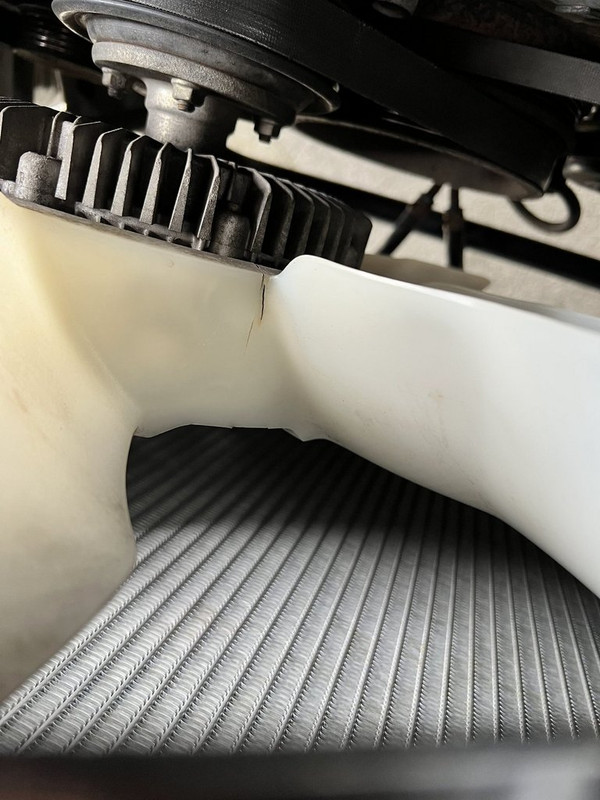

Hi folks,
I was replacing my radiator and took the chance to clean everything I could while the old radiator was out. The fan was black with soot and once I cleaned it I saw about 3 small cracks, the biggest one (pictured) is probably half an inch. Given that these cars use a fan clutch which exerts a lot more force on the blades than electric fans, should I replace it or is this a non-issue?

I think it's best to just replace it, you wouldn't want this possibly ruining your new radiator. I'm just saying.
Chris.

Sigh... I guess you are right, and I just checked and the blades are only $40 @ rockauto. The annoying thing is that I only noticed only after I put everything back together so that means another mess in the garage and more wasted coolant.
The more I look at that photo, the more it's clear that big crack goes all the way through.

The cracks on the fan are common. All of us have/had them but I have never seen a fan fail from the cracks.
You definitely do not need to drain any coolant to replace the fan. Just remove the bottom shroud and the fan should come out.
Ok then, perhaps it isn't that bad then. Thank you, guys.
