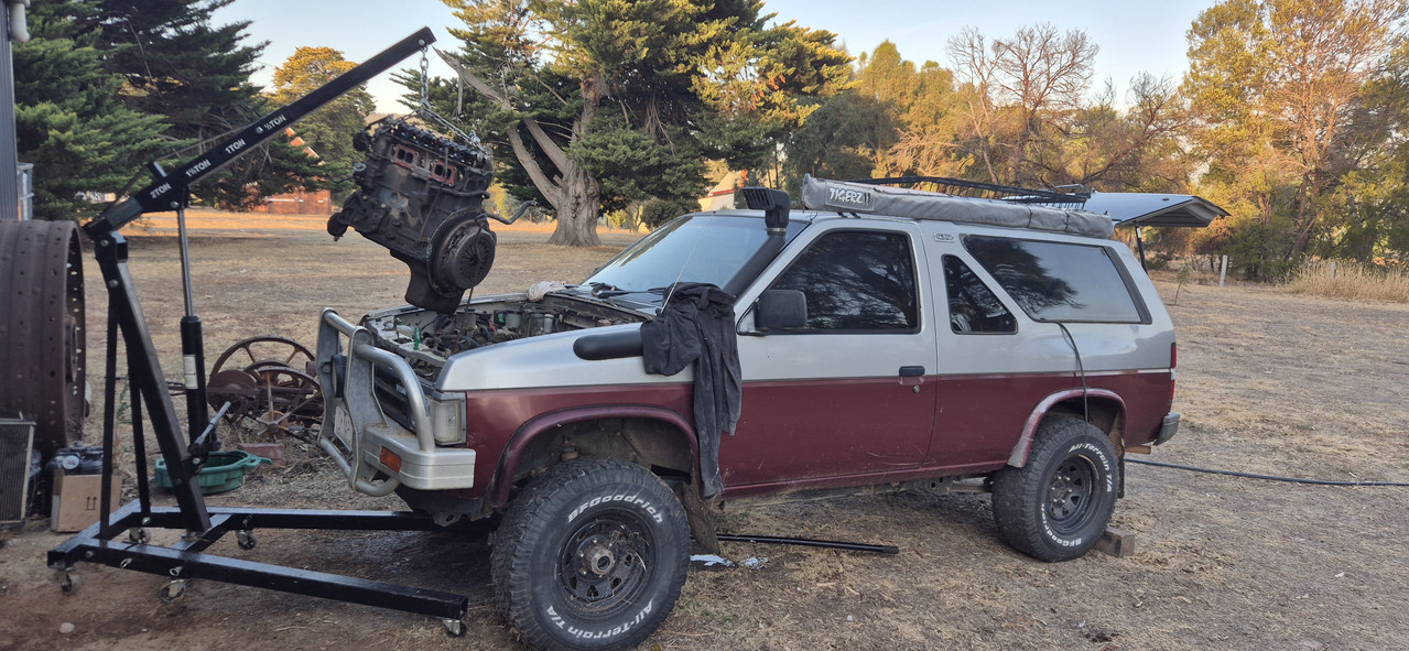

That didn't exactly go as planned.
Took her out Saturday and had a big end bearing or gudgeon pin failure, so time for a rebuild or heart transplant 🙄

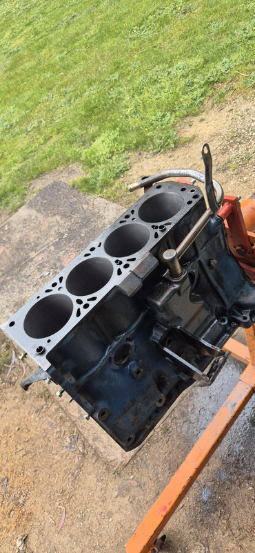

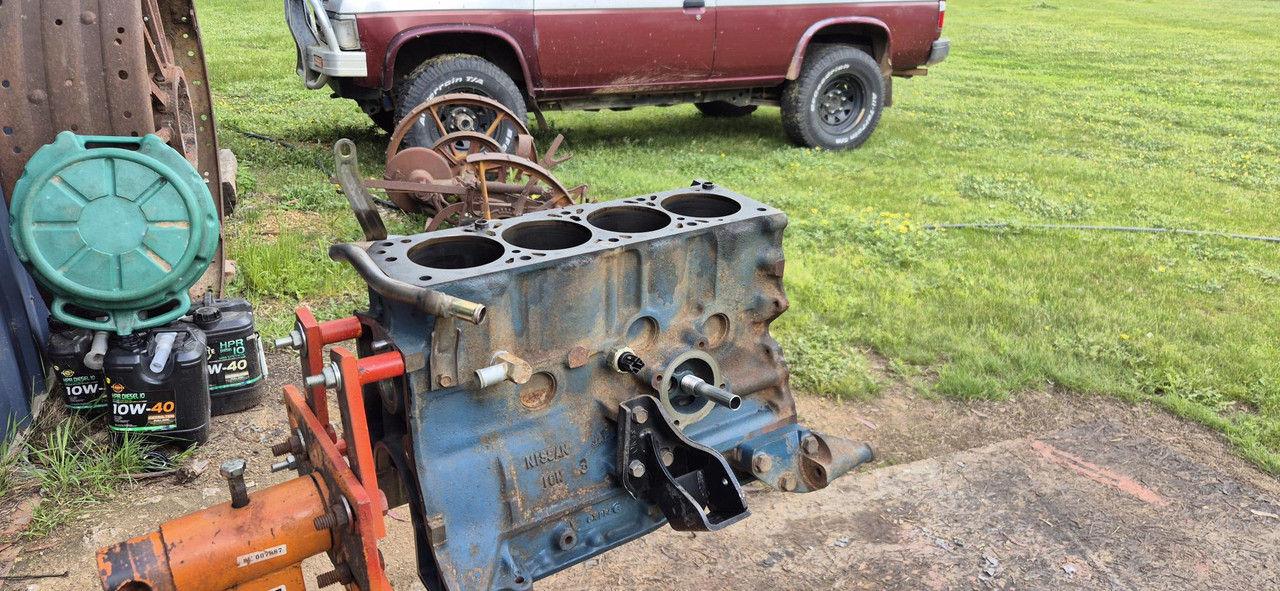

So, I pulled the original Z24 out from under my bench.
This was a runner, but smokey when I swapped it almost 20 years ago.
One piston (#3) had bad rings and ring lands.
Bores however, cleaned up nicely with a hone.
Waiting for parts now.

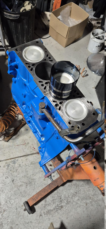

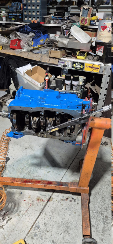

Crank and new main bearings in the big Z24 over the weekend, main bearing clearances and thrust all measured up great.
Pistons, rings and new clutch turned up last night
I just need to get the pistons pressed on and then I am ready to assemble.
Can't wait to have my old girl going again!

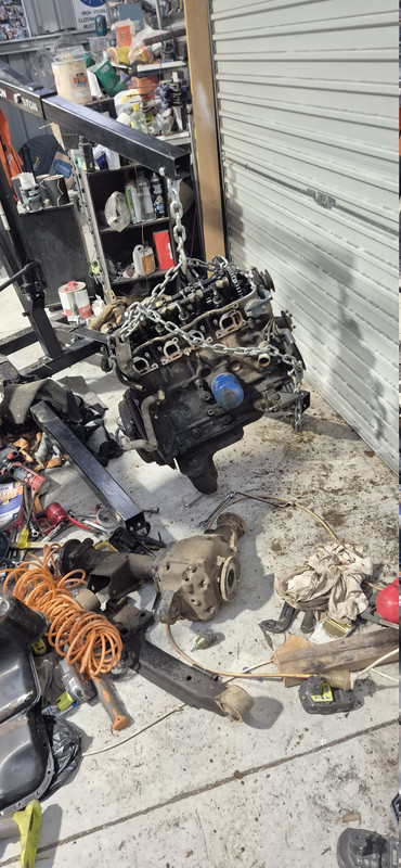

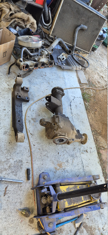

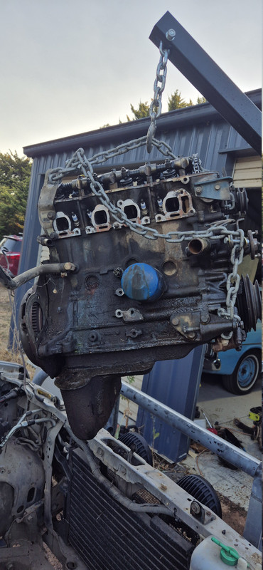

Still waiting for my pistons and rods, but decided to lift the old lump out.
Last time, I pulled the trans, this time I thought I'd try the method of removing the front diff.
Way easier than dropping the trans, but I will be honest - I am getting too old for any of this 😁
After having done this 3 or 4 times on Xterra and WD21 I'd agree pulling the diff is much easier than wrestling the transmission back far enough, because I also had to pry the torsion bar xmember down or just remove them.
Yeah, I've pulled the trans to do it before, it is a whole ordeal, plus I fitted a reconditioned trans a few years ago, not in a hurry to remove it again!

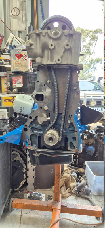

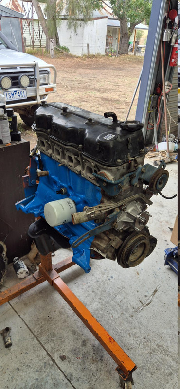

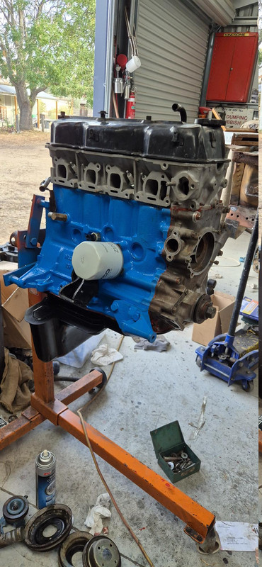

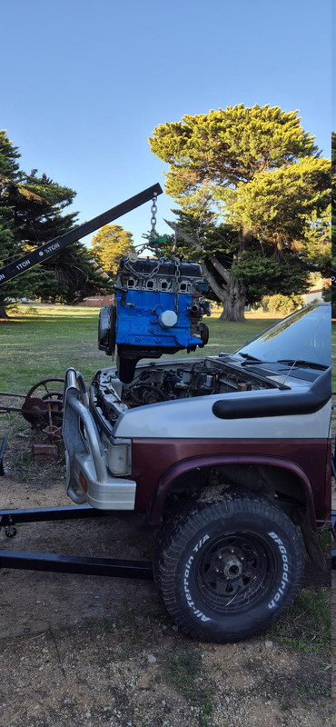

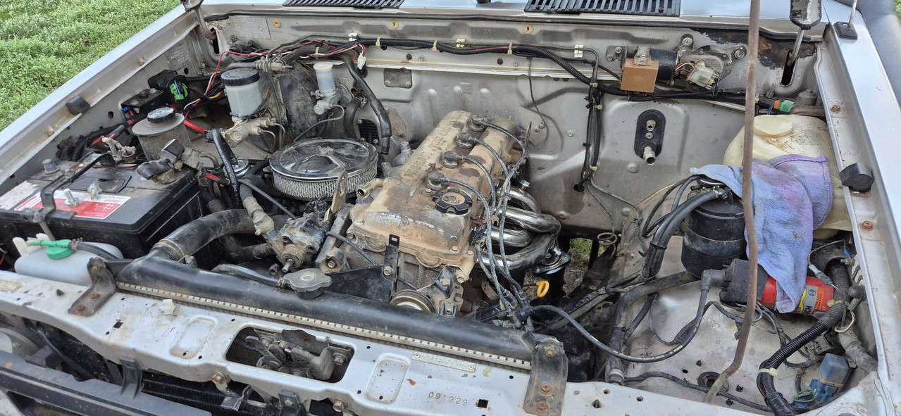

Finally got this engine built
New pistons, Rings, Bearings, Timing Chain, guides, tensioner, Water pump, clutch, plugs, leads, oil pump
First Start on Thursday, Yesterday I took it around the block, got a heat cycle through it then retorqued the head, set valve clearances and dialled the timing in.
It sounds and feels great!
Ready for the next 500,000 hopefully!!
