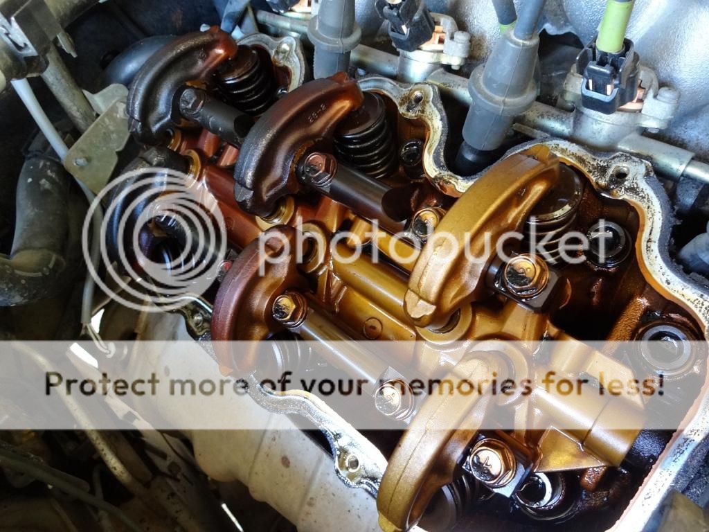

While I had a valve cover off today I noticed that there is some build-up on the rocker arms and also on the heads of some of the bolts, as can be seen in the picture below.DSC02623_zpscc71384a.jpg
Is this normal? There are 145K miles on the vehicle. I've only had the vehicle since 136K so I've only done a couple of oil changes, and I'm not sure what oil the previous owner was using or how often it was changed. Right now I'm using 10W30 conventional.

Thanks adamzan. I had a free voucher for an oil change at Firestone, so I took it in this morning. They use Kendall Synthetic Blend - never heard of it. I'll try something else for the next oil change. The reason I was concerned with sludge is the previous owner used the pathy to get around on his land and for short trips into town. I know that short trips can cause build-up.
Strange that there is so much difference in coloration, it makes me think that one end might not be getting sufficient oil. You might want to do an engine flush (usually a product that is left to run in a warm engine for a brief time, then flushed out) to see if it clears out any restrictions.

the change in color tone is due to heat, the rear of the motor gets more heat.
I don't think a few degrees should do that, especially in a water cooled motor. None of the few I have seen looked that way... :shrug:
