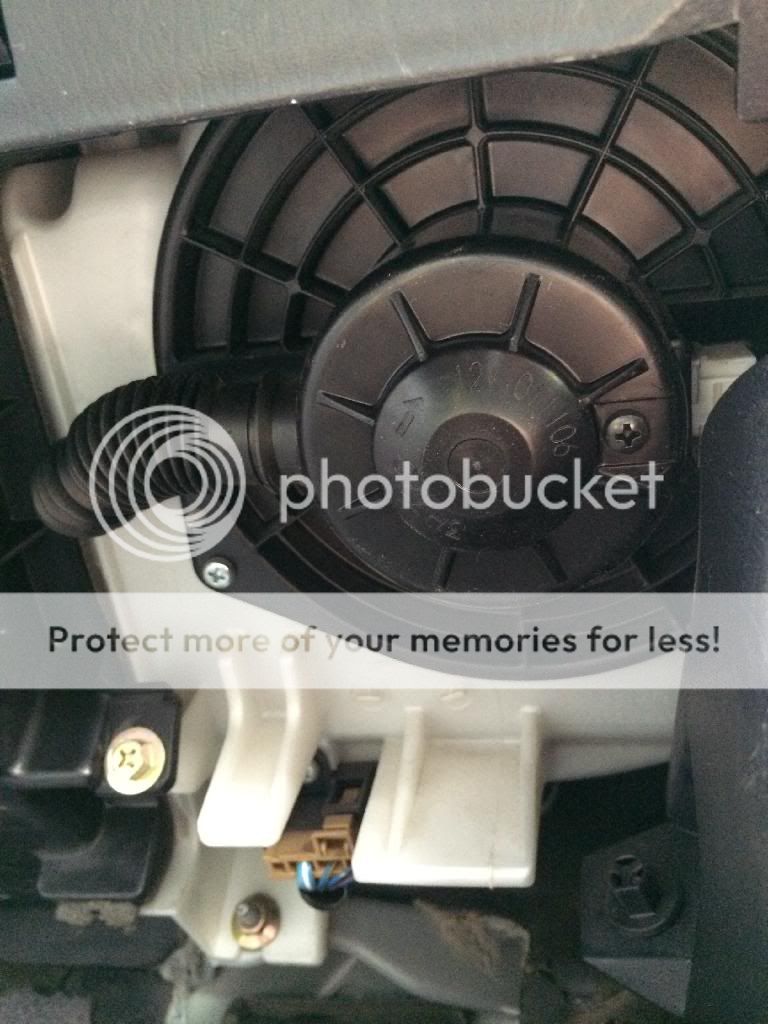

Karmann Posted March 2, 2014 Share Posted March 2, 2014 So this thing has been making a pretty consistent, chirping/squeaking noise, which is highly annoying. I know it is related to the HVAC, and have taken the cover off of it, but haven't been able to find any part numbers etc so I can replace it. Any help in identifying it is much appreciated. Thanks! Link to comment Share on other sites More sharing options...
Kyle94 Posted March 2, 2014 Share Posted March 2, 2014 ......this is your blower motor for your heating and aircondtioning..... or are you kidding? 1 Link to comment Share on other sites More sharing options...
adamzan Posted March 2, 2014 Share Posted March 2, 2014 Yes it is your blower motor. There is probably leaves and other crap in there. Take it out and clean/inspect. Link to comment Share on other sites More sharing options...

Karmann Posted March 4, 2014 Author Share Posted March 4, 2014 (edited) So I took the whole assembly apart, and the motor is toast, because there was actually no/little dirt buildup etc. Ordering a new one: has anyone ever heard of a company called TYC? Edited March 4, 2014 by Karmann Link to comment Share on other sites More sharing options...

ahardb0dy Posted March 4, 2014 Share Posted March 4, 2014 the one on my sentra was acting up, it would not work when on low unless I played with the fan switch, I took the blower motor out and took it apart, cleaned it and lubed the shaft and put it back in, works like new now. Also cleaned the squirrel cage it was dirty and was noisy from being out of balance. Link to comment Share on other sites More sharing options...
Karmann Posted March 4, 2014 Author Share Posted March 4, 2014 the one on my sentra was acting up, it would not work when on low unless I played with the fan switch, I took the blower motor out and took it apart, cleaned it and lubed the shaft and put it back in, works like new now. Also cleaned the squirrel cage it was dirty and was noisy from being out of balance. Hmm yeah I took the whole assembly apart and didn't notice any dirt deposits or anything, and I sprayed in some silicone: still bad Link to comment Share on other sites More sharing options...
ahardb0dy Posted March 4, 2014 Share Posted March 4, 2014 Did you take the motor apart? Link to comment Share on other sites More sharing options...

Karmann Posted March 4, 2014 Author Share Posted March 4, 2014 Did you take the motor apart? Yup and all clean, but made a ton of noise next time I fired it up. Link to comment Share on other sites More sharing options...
