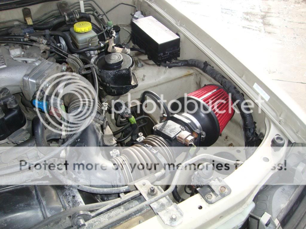

The intake has a TBS from Summit and a generic $20 O'Reilly's 3" "Spectrum"cone filter. The K&N was $40 so went cheap, used to run a Weapons R something or another. Any 3" will work for you, just gotta make a bracket to secure it and you're good to go.

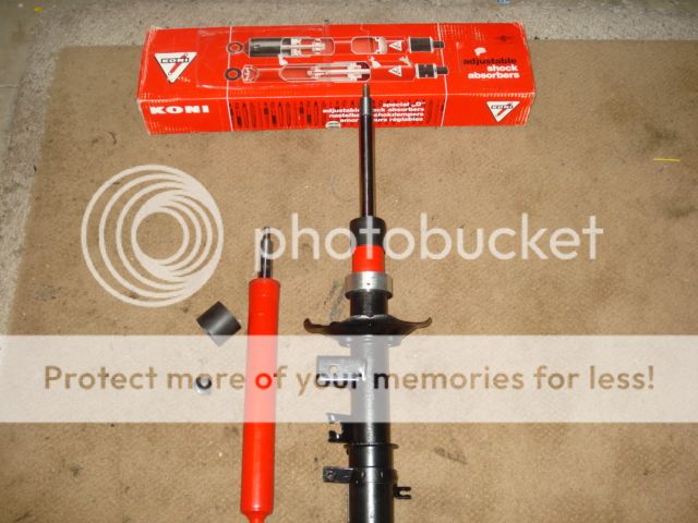

I gotta brag about my Koni strut inserts. Those were my best project. There're rebound adjustable and have a spacer at the bottom of the stock strut housing, therefore correcting the top out issue the AC coils create with KYB's or any stock strut. The collar I machined made it a perfect fit and it rides awesome.

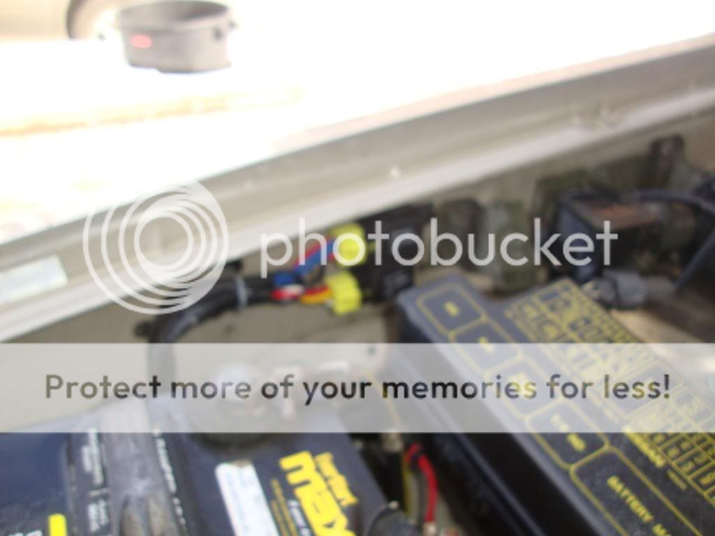

The blurry pic is my heavy duty in-line relay headlight wire harness attached to the fender well. It definetly improves the headlights with silverstar bulbs. The powersteering hose bracket came off pretty sweet, just copied the shape of the original, used some sheet matal and lengthen it, drilled the 4 holes and bolted it up. The panhard drop down bracket pushed the rear axle a little too much to passenger side but haven't got an alignment yet to be sure just eye balling it. Go figure, I put a 2" SFD with 2" AC coils and the rear is still raked.

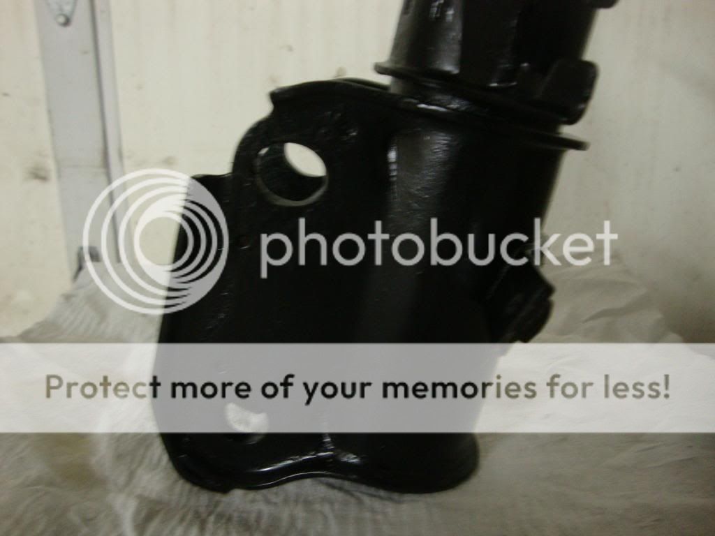

Try elongating the upper bolt hole on your strut body where the knuckle bolts. I did mine and it worked perfect for adjusting the the positive camber that the AC coils gave me. You have to have the stut out of the vehicle, use a drill bit of just slightly smaller diameter of the origianl bolt hole and rock it back and forth. It kinda gets oval but a rat tail file for finish up makes the hole pretty even. The area you want to take most of the material from is inward towards the body of the strut so no chance of weakening the attachment area. DSC06249.jpg

Not really not night and day but a little more mid-range and throttle response, but it might be a placebo affect. I did an intake mod, took the stock box out and put a 3" cone filter, removed rear exhaust resonator and put a magnaflow muffler and TBS. Sure it runs better I guess but still no race car if you know what I mean. With the intake filter you can hear a slight whistle as the air goes passed the MAF and the intake is louder, the muffler has a deep tone, so I like it. Gas mileage is terrible in this truck. When I run 31's it loses power considerably.
