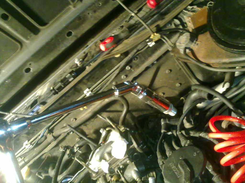

Leo94 Posted October 17, 2012 Share Posted October 17, 2012 (edited) It really isnt all that hard. I had to stand on my nudge bar though and kinda climb into the engine bay . Although you cant actually see the plug hole, you just have to feel around. I used a swivel joint and a long extension. The air hose is to blow away any dirt from falling into the spark plug hole which really helps if you have a large buildup. Edited February 27, 2013 by Leo94 Link to comment Share on other sites More sharing options...
Trogdor636 Posted October 17, 2012 Share Posted October 17, 2012 It really isnt all that hard. I had to stand on my nudge bar though and kinda climb into the engine bay . Although you cant actually see the plug hole, you just have to feel around. I used a swivel joint and a long extension. The air hose is to blow away any dirt from falling into the spark plug hole which really helps if you have a large buildup. That looks easy....try dealing with the intake on the fuel injected trucks. The difficulty goes up a few points. The first time sucks even with proper tools. But once you get it figured out how to arrange your extension, its not terrible. 1 Link to comment Share on other sites More sharing options...
