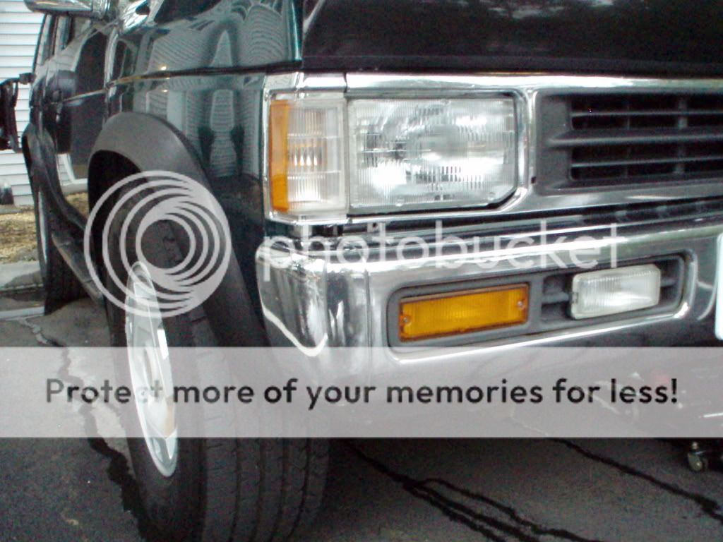

Also i just wanted to share with yall some pics of my rig before and after I put 1.25in wheel spacers on...
before
after
The last pic if you look close you can see the front one is done but i had not gotten to the rear one yet.
