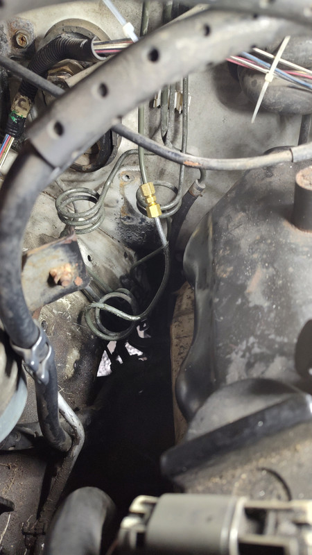

PamPoovey Posted October 6, 2024 Share Posted October 6, 2024 I should had just cut the hydraulic lines (using a Dremel) within the first 20minutes since neither bolt would budge. In the end, I end up sending that Nissan bypass part that was $20 and used this under $5 one (3/16 brass compression union) from Autozone, so the path didn't go as planned: Link to comment Share on other sites More sharing options...
Slartibartfast Posted October 7, 2024 Share Posted October 7, 2024 Stuck nuts make everything harder. Looks like it'll do! Link to comment Share on other sites More sharing options...
PamPoovey Posted October 7, 2024 Share Posted October 7, 2024 1 hour ago, Slartibartfast said: Stuck nuts make everything harder. Looks like it'll do! Vice grips got involved and still couldn't tackle it That Dremel has saved me countless times Thank you!!!! Link to comment Share on other sites More sharing options...
Slartibartfast Posted October 7, 2024 Share Posted October 7, 2024 No worries! Good to see you got it in the end. It is nice to have the option to turn the offending component into sparks. How's the pedal feel with the damper removed? Link to comment Share on other sites More sharing options...
PamPoovey Posted October 8, 2024 Share Posted October 8, 2024 The sparks was certainly a celebration! I think I may of actually had a beer that night! lol The pedal is stronger than ever -quite impressive! Thank you for asking! Zero damper is the way to go! Thank y'all so much for your support! It makes ALL the difference!!!!!! 1 Link to comment Share on other sites More sharing options...
