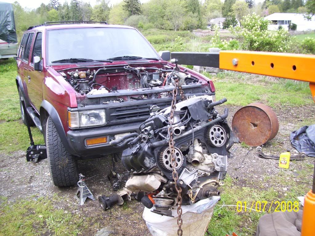

4wheeldrivefun Posted May 5, 2009 Author Share Posted May 5, 2009 (edited) I will post pictures of the busted oil pump very soon. I have not owned this truck very long. Other than when the oil light came on I have never ran it dry. What would or could case an oil pump to shater into like 4 busted parts. I got a new oil pump today from autozone it was 210.00 not cheap but the stupid auto shop wanted to charge me 1300. plus tax to install a new engine. I think this is a much better way to go. I will also be posting pictures of the car with out the engine it in etc. Ouch...that sucks. Edited May 5, 2009 by 4wheeldrivefun Link to comment Share on other sites More sharing options...
4wheeldrivefun Posted May 5, 2009 Author Share Posted May 5, 2009 Link to comment Share on other sites More sharing options...
k9sar Posted May 6, 2009 Share Posted May 6, 2009 I don't think it's supposed to look like that Link to comment Share on other sites More sharing options...
