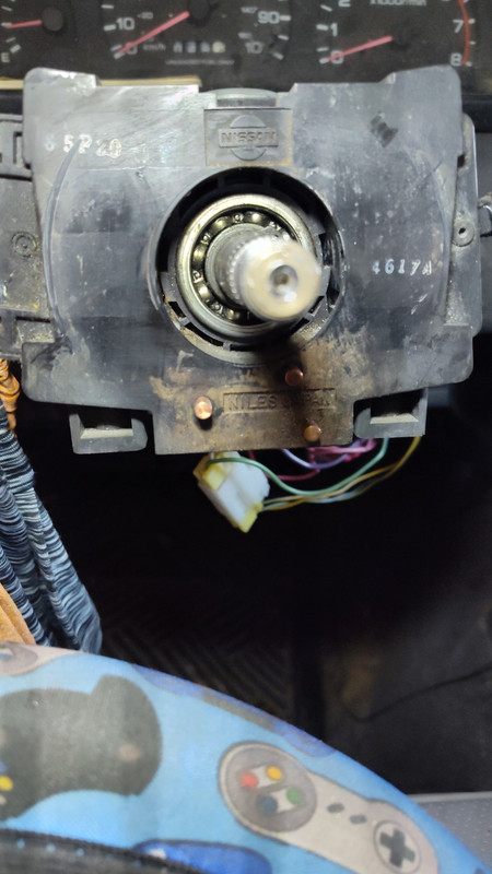

The worn down rods on the plates between the steering wheel and the shaft -does anyone happen to know a good replacing where to find it? I have yet to access them, but would love to get the horn working again.

I was able to get the horn working on my '95 just by cleaning up the contacts. If they're actually wore slap out, though, you may have to get creative. I don't think they're available on their own.
What year is yours? I've got a round-dash column sitting in my parts car, and AFAIK the contacts are still good.

Yeah, if it hasn't been off in a while, you'll probably need a puller. I think I used a harmonic balancer puller on mine. You could probably cobble something together from nuts and bolts and a piece of square tubing that would do the job. Make sure you've got the nut threaded back on a few turns if you're gonna keep yanking it by hand, or you'll end up wearing the wheel as a hockey mask. Oh, and mark the wheel and shaft with a paint pen if you haven't so it's easier to line it all back up when you're done.

Got your PM. I had a poke at my spare one. Haven't quite figured out how the assembly comes off the column, but I noticed something about the contacts.
Mine are sticking out at least twice as far as yours--but they're sprung, and when I pushed on them, one of them stayed down. Probably bound up by old grease and dirt. That dried peanut butter looking schmoo on yours is probably what's left of the grease, and in similar condition to what remains around the contacts. Shoot a little WD40 on those, give them a wiggle, maybe pull on them gently with pliers--see if they're actually worn all the way down, or if they're just shy.
Looks like there's a cover screwed on behind the plungers. I haven't taken mine off, but I suspect that's what you'll need to do to clean out the bores and get them freed up properly if they are just gummed up.
I'll have to give it a ago this weekend, most likely. I don't think I got peanut butter in there for they do bounce back when I push of them, so maybe, I got some graham crackers or Cheezits on them? I have owned this Pathy since 99, so decades of food crumbs and road dust!

After a long battle with the snap ring (I just haven't mastered the pliers, nor feel I ever will lol) Also, to find out after the fact, I never needed to mess with the snap-ring lmao  I finally got off the related parts and scrubbed all the contacts with white vinegar.
And this was after I couldn't remove anymore grime from the contacts
The horn works!!!! I don't know if the cruise control does, for I am still waiting on a slave clutch cylinder to arrive.
